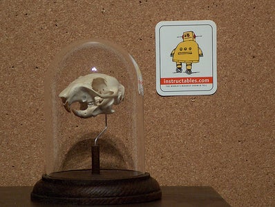

My favorite step due to the amount of tangible interaction and creativity needed. When building the display to fit your specimen be sure to keep in mind the desired orientation and feasibility of your final product.
While designing a metal mount for this particular skull, I had to keep in mind the small stature of the skull, the sleek design I was hoping to achieve, and the tedious design of a gravity fit mount (Easily disassemble-able with no glue) and removable lower jaw bone (also gravity fit). Depending on the intricacies of your design, a skull mounting may take more effort than the combined efforts that you have thus far reached.
My Simple Display Dome Components:
-Round wooden hobby plaque
-Cupped decorative glass dome
- 3" hole saw cutter with adapter
- 3/8" drill bit
- 3/8" wooden dowel
-Pack of micro drill bits
- 14 and 20 gauge wire
Base

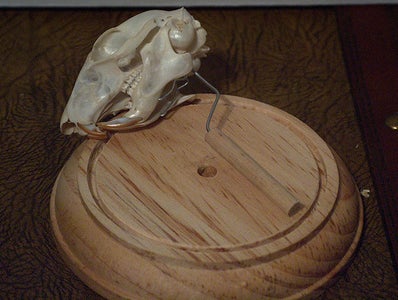

I began by centering the wooden plaque and fixing the 3/8" bit into the hole saw. Then, I Drilled the bit completely through the plaque and bored a 3" circular dado into it, allowing for a more stable dowel base and dome reservoir. The 3/8" wooden dowel should easily slide into the plaque center letting you to judge your preferred height; cut it there. Once it is cut, a 1/32" hole can be drilled in the top of the dowel for the 14 gauge wire.
Wiring

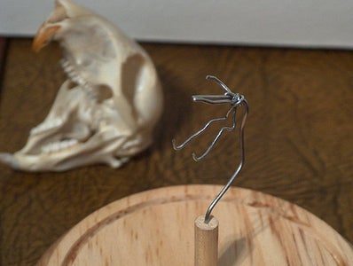

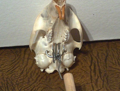

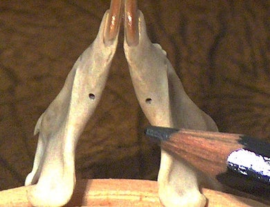

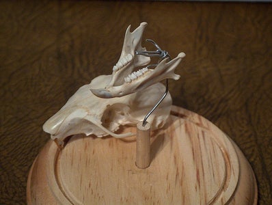

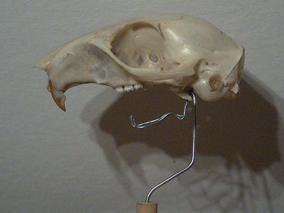

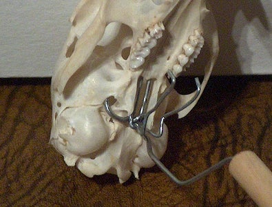

At this point I drilled two 1/64" holes into the lower mandible and cut a 5" section of 20 gauge wire. Before trying to assemble the lower jaw mount I formed a longer section of the 14 gauge wire into a stable mount for the upper skull. My design goal being that the skull was easily disassembled, I made sure to design the top mount so that the curved wire section slid into the skull and was fitted by gravity. After perfecting the upper half of the wire mount I attached the 5" 20 gauge wire to it and formed it to the lower mandible's dimensions. While working on the mandible I kept in design my goal of a sleek frame and actually curved the wires up into the inside of the jaw. > Keep in mind this process is extremely tedious and frustrating, I recommend breaks during wire mounting to avoid accidents. Its far better to have a break from your project than one in it. <
Assembly

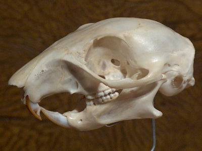

Once I finished the wire portion I cut the end of the wire mount (14 gauge) so that the top of the skull would reach 3/4's of the way up into the dome. After that, I simply attached the wire mount into the dowel, also friction fit, and gave the wire some final minute adjustments. Once the skull passed my judgement I carefully stained the plaque and added a non-slip layer to the bottom of the plaque for a nice touch.
