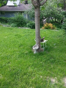

This is how I made my portable slackline used between to trees that is very reliable. It requires minimal supplies and low cost for hours of entertainment. Make sure you tree's that are going to be strong enough. I reccomend about one foot diameter at least to about a foot and a half. The distance we used was about 15 feet apart but depending on trees this could be shorter or longer.

Step 2: Add Tow Ropes to Trees
The most important thing is to get two trees a good distance apart that are strong enough to hold the slackline. Once you have the trees picked out start by wrapping one of the tow straps around the tree. Do this about 1 foot off the ground. That will determine the height of your slack line. Wrap it around as many times as you can and then hook the two clip together. Then Pull the rope part tight so that the hook are tight and you have an area to hook the ratchet strap onto the rope part. Then on the other tree you previously selected do the same thing wrapping the tow rope around the tree hooking the clamps and pulling tight a spot on the rope part to hook the other end of the ratchet strap.
