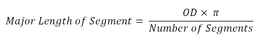

The calculations of the segments may sound scary, but they are quite simple.
Once you have the idea of your bowl sketched out, figure out what the OD (outside diameter) and ID (inside diameter) need to be. This will correlate to the width of your stock (all the math shown will be based off the top ring shown in yellow on my sketch. Apply the same math with each ring).
From the sketch we can see that our OD is 7.5 inches and our ID is 5.5 inches. To calculate the length needed on the exterior of each segment take the OD multiply it by Pi and divide that by the number of segments in the ring.
For this ring (7.5 x 3.14) / 18 = 1.309 inches

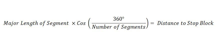

However, you cannot set your stop block to this length! You must do one more calculation to know where to set your stop block.

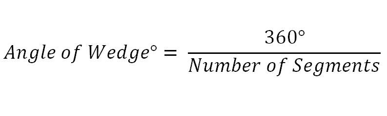

To calculate the distance of your stop block, you must take the major length of your segment and multiply it by the cosine of the angle of your wedge.
For this ring 1.309 x Cos (360 / 18) = 1.230 inches ~ 1 1/4 inches
Now set your stop block to this length and you are good to go! See, wasn't that easy!
