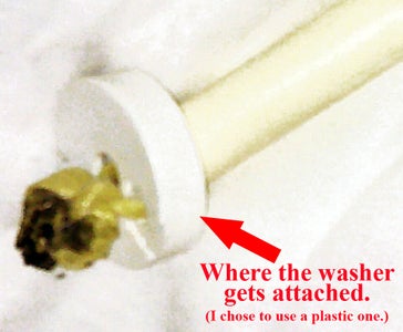

Step 2: Thread Both Loose Ends of the Rope Through the Washer and Tie in a Knot.
(This prevents the rope from getting lost down the PVC Pipe, as well as gives you a (sort-of) handle.)
