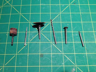

Tools Recommended:
  • Small Saw (or use the Dremel cut-off wheels),
  • X-ACTO Knife (for cutting the paper template)
Recommended Dremel bits:
  • 456 1-1/2" Fiberglass Reinforced Cut-off Wheels (Cutting out the pieces)
  • 561 MultiPurpose Cutting Bit (for the slots)
  • 407 1/2" Sanding Drum (Sanding, Curves)
  • 7134 Diamond Wheel Point (Cleanup, adjustments)
  • 106 Engraving Cutter (For the etched logo)
  • 199 High Speed Cutter (Starting the slots).

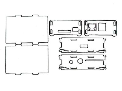

Step 2: Measure, Trace, and Cut
  1. Find a template or use the same one I did. If you can print it on a card stock it makes it a little easier to trace and cut, otherwise regular printer paper is fin, just a little delicate around the edges and smaller gaps.
  2. Print to right scale. I used the spacing between the Audio and Video components and the ruler tool in photoshop to get the approximate size, I resized the image to get a match, don't worry about any loss or blurriness.
  3. I simplified the edges to just simple slots rather than locking flexing clips. It was too difficult at that small of scale to accomplish with my skill set.
  4. Cut out the piece out of paper using an x-acto knife, then trace the shape on to the wood with a pencil.
  5. Start cutting out all the parts using the Dremel bits.
