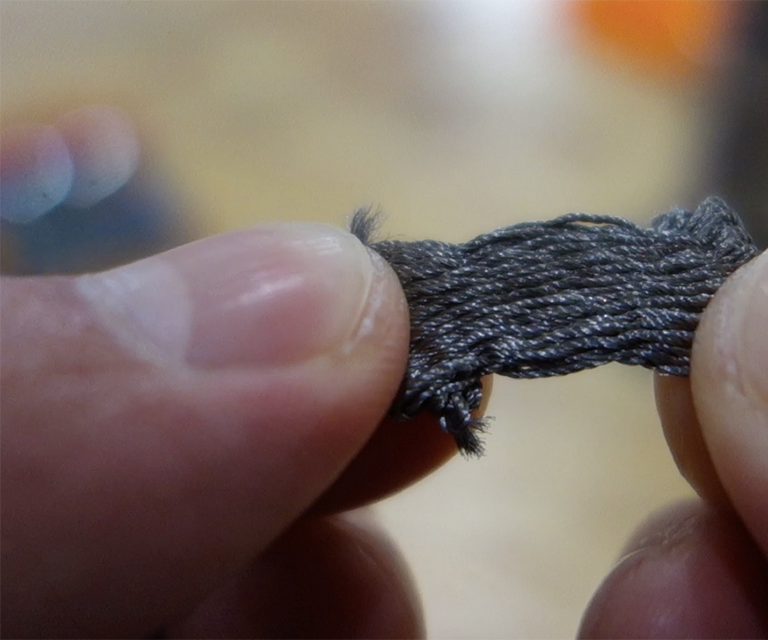

To prepare your fabric, pop a bobbin of conductive thread into your sewing machine. You can wind your own, or you can get these pre-wound from several sources like Adafruit, Sparkfun or Seeedstudio.
Take two pieces of fabric larger than the square patterns that you cut out. Sew diagonally across the fabric pieces on the bias. You may want to practice on a scrap piece first. Check the tension of your machine. A good trick for sewing with conductive thread in the bobbin is slightly lowering the tension of the top thread so the bobbin thread floats a little bit. This sometimes jams the machine, however, so be aware.
After sewing diagonally, sew a square pattern on one of the pieces and a cross-hair pattern on the other. You may want to draw it out with tailor's chalk beforehand to help guide you. Test the pieces with a multimeter to make sure the conductive thread connects to each other from end to end.
