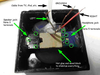

Step 2: Schematic:

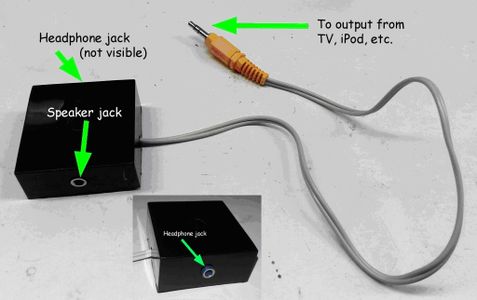

Step 3: Assemble Parts in Enclosure
* Drill holes in opposite sides of enclosure.
* Hot glue Speaker and Headphone jacks in place.
* Prepare input cable for soldering. Note ground wires from Right and Left are joined.
* Hot glue input cable in place.

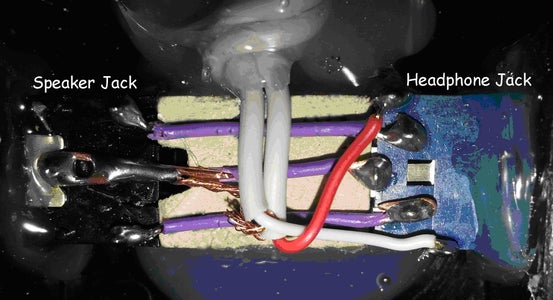

Step 4:
Solder:
* Right terminal of Speaker Jack to INNER right terminal of headphone jack.
* Left terminal of Speaker Jack to INNER left terminal of headphone jack.
* Ground terminals of both jacks to each other and to common ground of Right and Left input cable.
* Right signal from input cable to OUTER right terminal of headphone jack.
* Left signal from input cable to OUTER left terminal of headphone jack.
Step 5: Enjoy
* Plug in input from TV or other audio source.
* Plug in speakers.
* Music will be heard from speakers until headphone plugged in.
