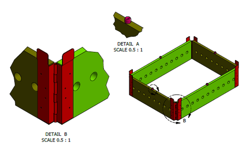

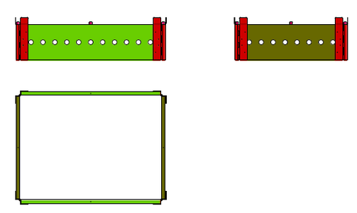

Step 2: Drawing
You will be building to this drawing. Note that the design can be scaled up or down. However, check the math for the sides if you want it fully collapsible.

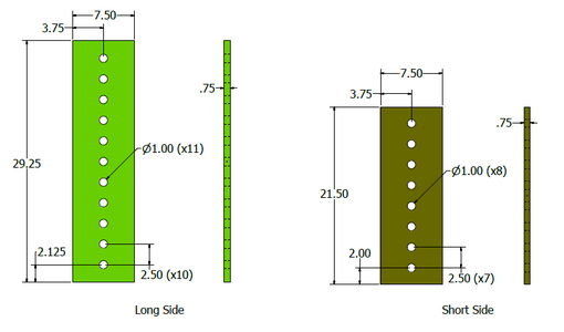

Step 3: Cut Sides
Cut wood as shown. The optional holes are used to improve aeration to the compost. Make 8 of each piece.

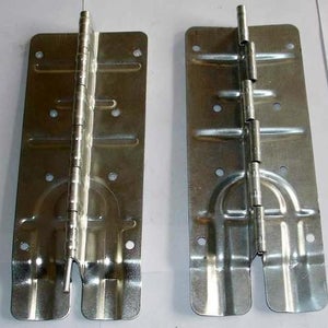

Step 5: Add Hinges
Add hinges to sides with nails or screws as shown. Optional: To increase ventilation, add 1/2" tall rubber bumpers to the bottom side of each board. Repeat for the desired number of stacks – 4 are shown in this design.

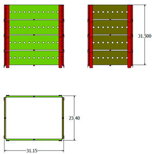

Step 6: Stack
Stack the tiers together by lining up the corners.

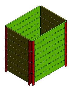

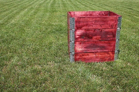

Step 7: Final Product!
No holes were added. Rubber spacers will be added before installation.
