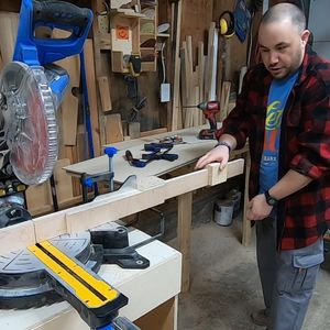

As I noted in the supplies section, I used some scrap plywood for this project. I choose plywood over solid wood as it is more stable and more likely to stay straight, but if all you have is solid wood, then use that!
The two pieces I had on hand were 2 1/2" x 38". I cut one of them to 22" (the remainder of this piece will become the stop block in coming steps)

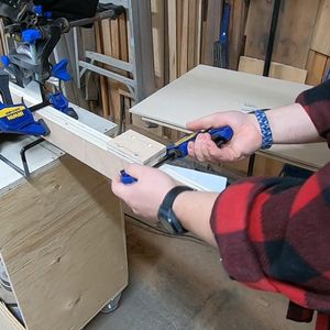

Using some 3/4" pan head screws I attached the plywood to the miter saw using the holes in the fence. I made sure to line it up so that the plywood pieces meet in the middle.

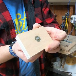

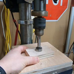

I used a 3/4" forstner bit to drill a small recess in the center. I only went down about 1/8" (until the t-nut was flush when sitting in the recess)
I then used a 5/16" to drill the rest of the way through.

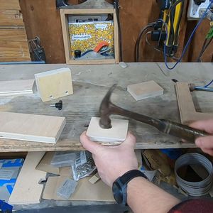

If you are smarter than me than you will get a knob that is long enough that it will go all the way through the plywood and stick out the other side. Since I was using the bits I had on hand, I had to drill a recess in the back. This allowed the knob to have clearance so that it could be screwed in far enough that the threads stuck out on the other side. I used a 1" forstner bit for this recess.
Next I hammered the t-nut into the plywood and tested it out to make sure everything worked the way I intended.

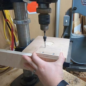

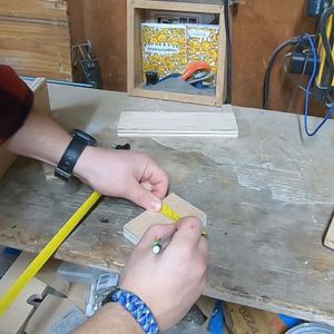

To make the top of the stop block I first measured 3/8" from one of the sides and drew a line. (I used 3/8" because that is the center of a 3/4" board, if you are using a different size than adjust accordingly)

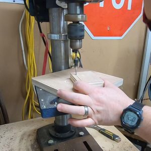

Using my drill press and a counter sink bit, I drilled 2 holes along the line.

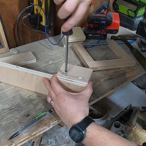

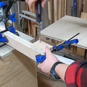

To attach the top to the front I use 2 x 1 1/4" screws. I made sure to line up the top so that it was flush with the front piece.

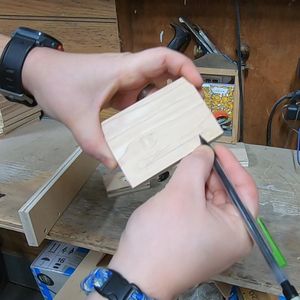

To attach the back to the stop block I first had to figure out where to drill the hole. I placed the front and top piece on the fence and then slid the back piece in place. I made a mark with my pencil. I was then able to continue that line all the way up and over to the top.
I took the top piece over the to the drill press and drilled some countersunk holes along the line.
I wanted to have a bit of a clearance gap to ensure smooth movement of the stop block so I added a sheet of paper before clamping it in place. I then attached it all together using 1 1/2" screws.

Now we are all done! Picture #1 shows the two different stop blocks sitting on the fence.

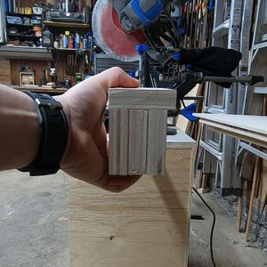

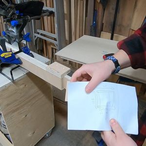

Pictures #2 and #3 show the extended stop block for making short cuts and pictures #4 and #5 show the regular stop block for making longer cuts.
