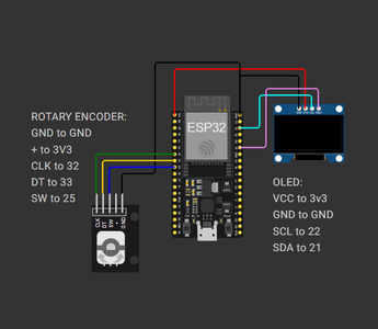

Step 1: Connections
Refer this connection diagram and connect the wires on the bottom side of the OLED and Rotary Encoder.

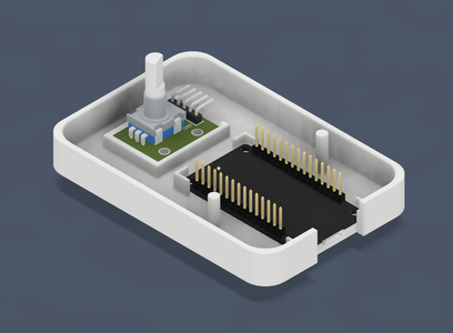

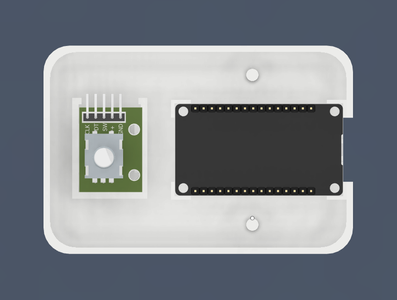

Step 3: Assembly: ESP32 and Rotary Encoder
Follow the images one by one.
make sure to hotlglue these parts in their places.

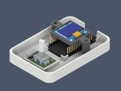

Step 4: OLED
Make sure the wires of the oled are soldered on the bottom side. I have soldered them by mistake in the video on the top but you have to solder them on the bottom so the part can fit.
