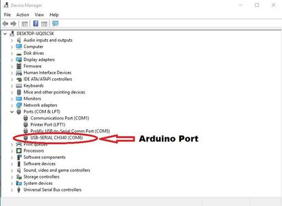

Now we need to determine on which port is installed the Arduino microcontroller, because we will need this information later.
The consumption of the Tuner module is about 100 milliamps, so we can power it directly from the microcontroller. Now we start the PC Application, and select the communication method, in this case through serial port COM 6. We press OK and the radio starts working on the frequency that we can previously define in the settings tab.

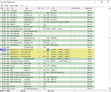

TEF-GTK appplication also supports external Applications. One of them is "Station List" aplpplication, that shows the name of current radio station, the country from wich it is broadcast, the strenght and location of repeater, and other useful informations.
