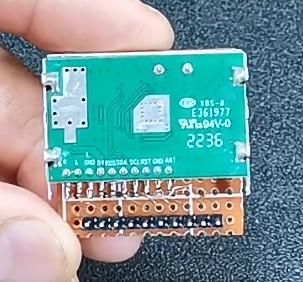

 The TEF6686 radio module is intended for AM/FM receivers for cars. This miniature module has amazing possibilities, great sensitivity and selectivity, adjustable de-emphasis and filter. It has an output analog audio L + R, or MPX, depending on the configuration. Also, it has an I2C communication protocol, through which the module can be easily controlled by a microcontroller.

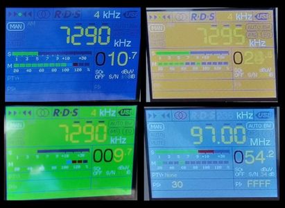

The main screen appears immediately after the logo.
On it we can see all the information and the frequency is marked in the middle with big numbers. Here is the reception information such as RDS, stereo reception, bandwidth, mute, manual and automatic dialing, as well as reception signal strength in the form of a bar and a numerical value. Turning the encoder changes the frequency. The green arrow shows us which digit we are changing (that is the dialing step).

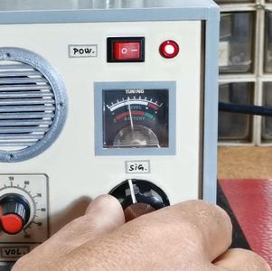

  - This is the Squelch function potentiometer
  - and volume potentiometer
 An analog instrument is optional, and displays the received signal strength.
