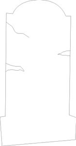

I searched the internet for the shapes of tombstones that I liked. Then I downloaded the picture and put it into Corel Draw to outline the basic shape and turn it into a pattern.
If you don't want to do this, or don't have the software, I have included some of the stones that I drew if you want to use them. If you don't want to use my drawings, then you could always print out a picture of the stone you like to whatever size you want and trace the outside. You could also draw it free hand onto the protective coating that the foam has.
A freeware program thats like Corel Draw is called Inkscape

Print out the pattern that you like. Cut and tape the pattern together.
Use spray glue and attach the pattern onto the 1 or 2 inch thick foam board
After the pattern is attached. Take your cutting implement and start with the straight cuts first. Then do the curved cuts. I used a jigsaw to cut the foam board because it was the easiest for larger tombstones. Small tombstones were easier to do on my bandsaw.
