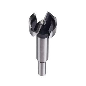

A big Fostner bit, the bit needs to be a bit bigger than the diameter of the wheels you're using. I used 2" diam wheels, so I used a 2.25" diam Forstner bit.

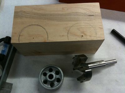

Using the wheel, mark with a pencil where on the wood block you would like them placed. Mark the center of the wheel with a nail or screw. The center of the wheel should have at least 1/4" of material below it. Do this for only the two wheels on one side.
Warning: Only use a drill press if you are experienced and comfortable with it. And always wear eye protection.
Using the smallest diamter drill bit in a drill press, drill all the way through the block of wood at the two points you marked.

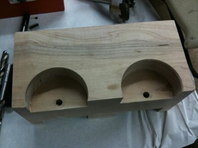

Using the Forstner bit in the drill press, drill down the thickness of the wheels using the small diameter holes you drilled previously as center marks. Flip the block, and then drill two more holes, again using the small diameter holes as center marks.
Use the remaining drill bit in the drill press, drill two through holes, again using the small diameter holes as center marks.

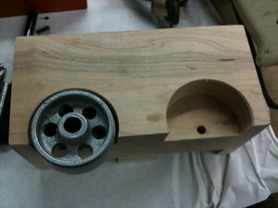

Make sure your wheels fit inside of the newly drilled wheel wells.

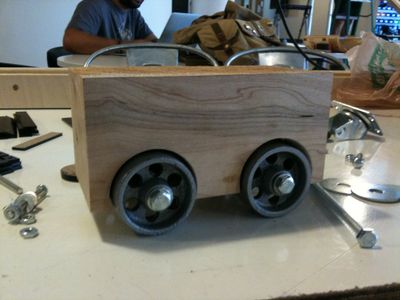

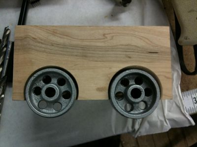

Step 3: Put It All Together
Put one wheel on the bolt, push it through the wooden block, put another wheel on the bolt, attach the nut, and tighten with a wrench. Repeat these steps for the other set of wheels.
Congratulations, you're done.
You can leave the wooden block raw or paint it or do whatever, have fun with it.
