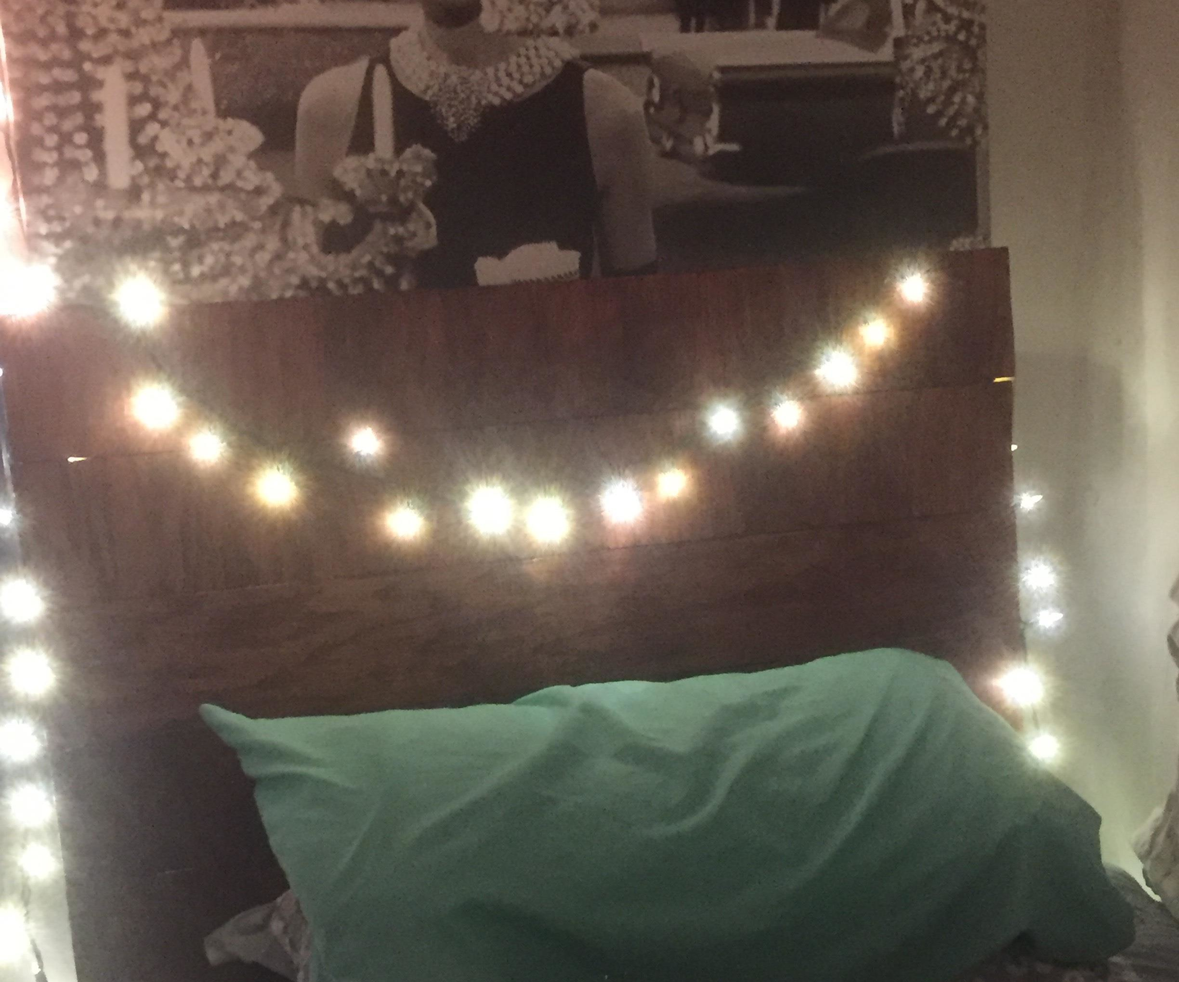

The completed product looks great in my room. I am very happy with how it came out. If I could go back and make a few improvements, I would definitely add and extra bench piece in the wide cracks when the futon frame is laid out so the mattress will be a bit more comfortable. I would also clean up the edges and cut them more neatly instead of last second cutting them.
Check out the final pictures of it in my dorm.
