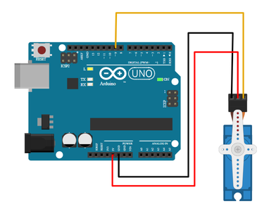

Step 7: Wiring
Using the M-M jumper cables and the included diagram for reference, wire the Servo motor to your Arduino. The color of your jumper cables, but I prefer to color-code my circuits so that they're easier to troubleshoot--red for power, black for ground, and yellow for the signal (pin 9).
You can either connect directly to your Arduino or use a breadboard/breakout board as an intermediary between the Arduino and motor. (I would recommend doing the latter if you're planning on expanding this circuit to include more components, such as LED lights, sensors, or more Servo motors.)
(Diagram created using this free browser-based tool.)
