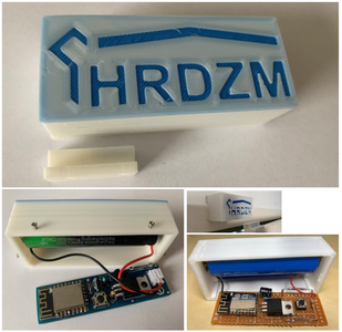

This instruction will shows how a battery powered door/window sensor can be build and integrated in eg. FHEM home automation solution.
The solution is based on SHRDZM device sensor platform which supports multiple different sensor integration with low power consumption.
This integration is focused on ultra-low-power consumption to run the sensor for long time without changing the battery.
To reach this goal, the sensor should consume energy only if the door is closing or opening for a few hundred milliseconds.
It detects opening as well as closing events.

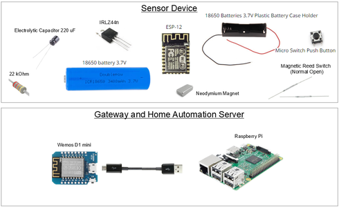

Step 1: What Is Needed
There are several types of integrations for a SHRDZM device possible.
This instruction shows the Integration Style I. With this Integration Style, the gateway is directly connected via USB. For other styles of integration, please visit the SHRDZM Wiki. Instead of the Wemos D1 mini, each other type of ESP8266 based module can be used. (eg. NodeMCU)

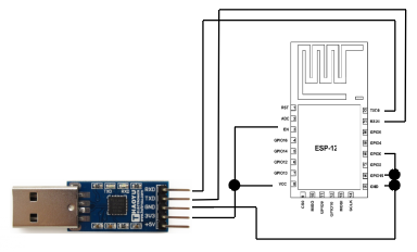

Step 2: Flashing Firmware
For initial flashing of the firmware onto the sensor device, you need a CP2102 USB to UART adapter.
Flashing Instruction Sensor Device
Flashing Instruction Gateway
Step 3: How to Wire the Sensor Device

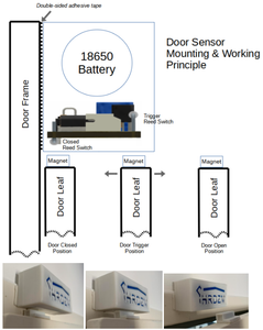

Step 4: Mounting Principle
Place the SHRDZMSensor above the door leaf onto the door frame with a double sided adhesive tape.
Directly below on the door leave, place the magnet.
It is important to mount the magnet on a position where the 'Closed Reed Switch' contact is tightened when the door is fully closed.
At the same position, the 'Trigger Reed Switch' must not be tightened.
