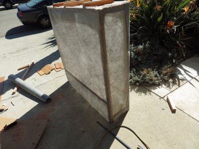

Step 4: Glue and Screw the Braces Into the Base and Each Other
Have a friend help you. I think the pictures describe it better than anything I can think of here.
Step 5: Wrap and Staple Weed Cloth Around Braces.
It is a lot easier with a friend to help you.

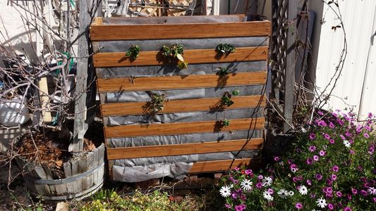

Step 6: Begin Applying Planks
It is very import that you have planks all the way around top and bottom to hold the soil in. After that have some spacing between the planks. It looks best if the spacing is even so I uses planks to measure the distance between the planks.
Glue and screw the planks in. I also tried using an air nailer for speed and found that the bamboo planks were and redwood were a bit tougher than my finishing nailer ...

Step 8: Fill With Dirt and Plant Strawberries
This planter takes approximately 18 cubic feet of dirt to fill (4' x 4' x1' = 16 cubic feet, round to 18 cubic feet). This required two trips to pick up soil in my electric car (which I also built at my house).
Pour the soil into the planter. If you tear any holes in the weed fabric, or want to cover up from a plant you removed, no problem, just insert some more fabric inside the slats and you are good to go.
Test drainage.
Cut holes and insert strawberry plants.
Water with a transplant fertilizer.
Add to watering system (I use a drip system so I added 2 drip sprinkles and that seems to full water the planter).
Wait impatiently for strawberries.
