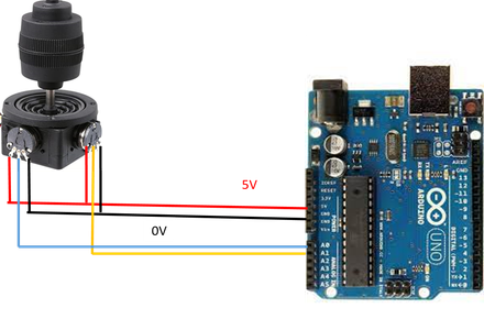

Step 2: Block Diagram
The block diagram shown in the figure explains the interconnection between the joystick and Arduino Uno, as in the diagram the output of the joystick (middle pins) are connected to A0 and A1 of the Arduino. likewise the VCC and GRD are connected from the Arduino to the joystick. The final result is shown in the serial monitor of the Arduino.
Step 3: Hardware Connections
The hardware connection shown in the figure begins with soldering the three pins of the joystick as in the figure two and three. Then both VCC in both sides (red color) are connected together to 5V of the Arduino, similarly the negative terminals (black color) are both connected to the ground of the Arduino. The outputs of both sides are the meddle pins and connected to analogy pins of the Arduino A0 and A1. The final connection is shown in the last photo.
