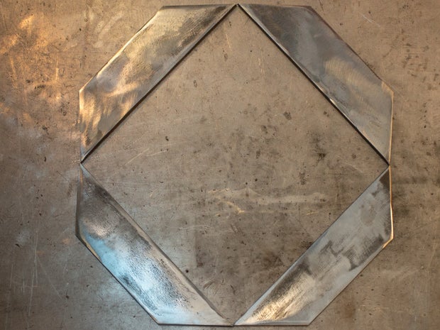

Gather your mitred lengths of square tube and begin to seat them together with welding clamps or magnets.
Check the sqaure-ness of your top with a steel square, as well as with a measuring tape. You know you have nested your parts perfectly square when each of your diagonals of measure out to the same value. Make sure that your parts are aligning on the same planes as well, welding uneven material can be a pain once you get to grinding.

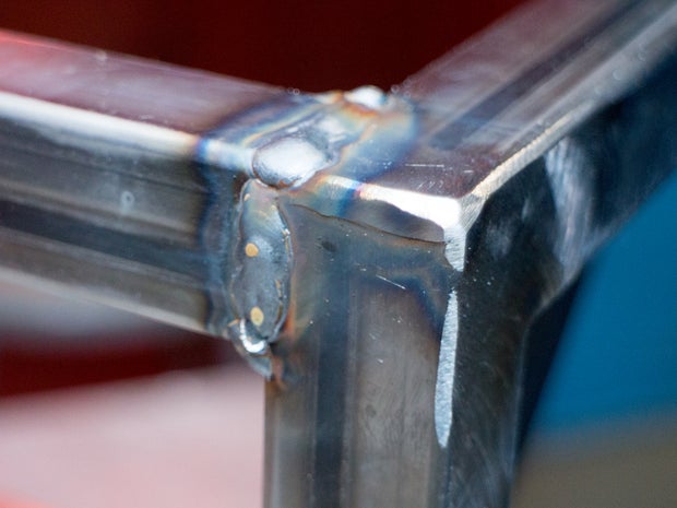

Once you have made certain that your parts are seated properly and are square AND flush, fire up your welder with the right settings for 16 ga. material place a tack weld in the top outer corners. Carefully flip your work over and tack the inside corners, flip again to get the inside corners of the other side, and one last time to tack the outer corners. We work this way so we can minimize heat distortion before we start forming weld beads around our cuts.
Once you have tacked your piece sufficiently, you can begin running weld beads along the top, bottom, and outside edge. There isn't really a need to try and jam your welding torch into that last inside edge to try and fillet weld the tube shut, unless you want this stool to go outside. The top is pretty much structurally strong once they are welded on just one side, but we weld 3 sides shut so that the surface will be smooth once we grind out our weld.
Tip: Welding thin-gauge square tube along the edges can lead to gaps and holes in your base material. If this occurs, it's a breeze to fix. With the tip of the torch move around the perimeter of you gap making small tack welds. This does mean that you have to spend more time grinding, so it pays to get your settings right the first time.

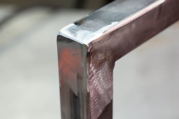

Grind out your welds, and make sure you don't have any holes in your weld before welding the outside edge shut. This edge will burn up quickly so consider lowering your voltage setting slightly. Smooth out all your welds with an angle grinder so that you have a continuous square-tube square-top :D.

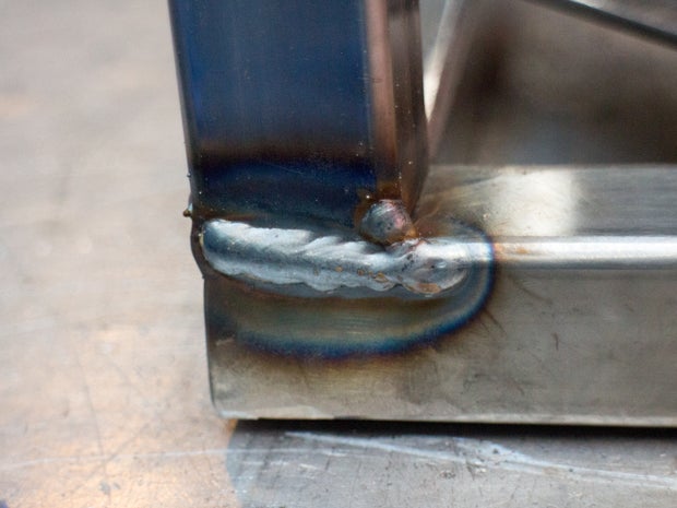

Once you completed building the top and the cross supports, you're ready to add the legs of the piece. This part of the build is the least amount of welding, but the most amount of measuring and squaring.
Begin by squaring, tacking, and welding the legs to the top. Be sure your welds are squared along the planes of each side, as well as the corner. You only need to perform two tacks and two weld beads along the outer edges for these pieces to be structurally sound. Any more welding at these joints will lead to unnecessary and timely grinding.
Once the legs are welded into place, weld the cross beams into place. I chose to weld the cross-beam 14 inches down from the base of the top, but feel free to modify the design in any way you see fit.

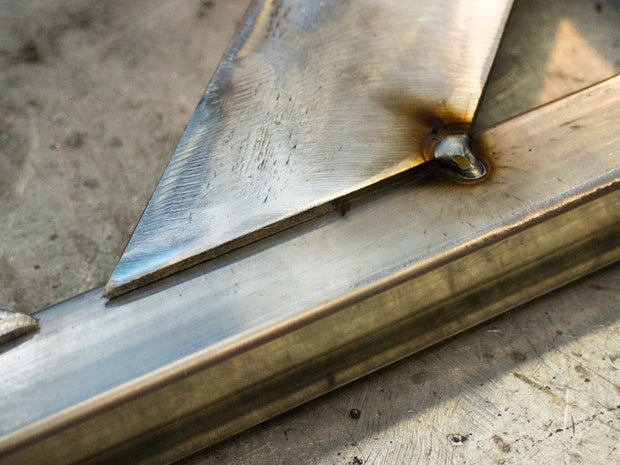

The last steps for welding and grinding this project is adding the supports that will hold the top. After milling the mill scale off of the mitered flat-bar, square fit it to the top of your project.
Set, tack, and run weld beads along the cut edge of your flat bar, securing it to the tube stock of the top.
If you need a refresher on how to execute a lap weld, check out the Welded Joints lesson. As you run the torch along the edge, you want to 'grab' the upper lip of the material with puddle, pulling it down towards the base material.
You want to set your welders' heat and feed settings for the thinnest material that you're working with. This means that even though we are working with a flat bar that is thicker than our tube-stock, we prevent burning out our tube stock by using settings suited for 16 gauge steel. I chose not to grind out these welds, because no one will ever see them. You will want to grind out all the remaining raised welds from previous steps, and potentially re-chamfer the edges along the corners of tube stock that have become sharp from grinding.
