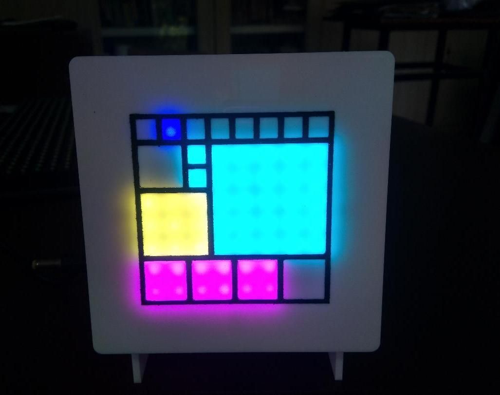

This is my new clock with five minute least count. I love clocks with multiple colors. The LED glow with RED color for hours , GREEN color for Minutes, and BLUE color if hour and minutes overlap.
Esp-01 ws2812 shield, Esp-01 ,DC Socket, 5V DC adaptor, Neo pixel ring 12 bit

Assemble the enclosure as shown in the picture. Tighten the neo pixel ring with nut bolts. Then stick the ring for covering the led’s with double tape on its place. Glue two spacers with large hole on the front. And paste the acrylic sheet with thin double tape.

Step 5: Reading Time
First picture shows one o clock, Second Picture shows 12 hr 55 min, third pic shows 1 hr 5 min
