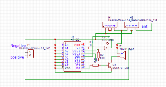

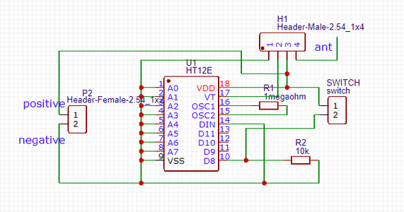

Step 4: Follow the Circuit
Rf transmitter circuit-goo.gl/knTrDq
Rf receiver circuit-goo.gl/wA5LDY
