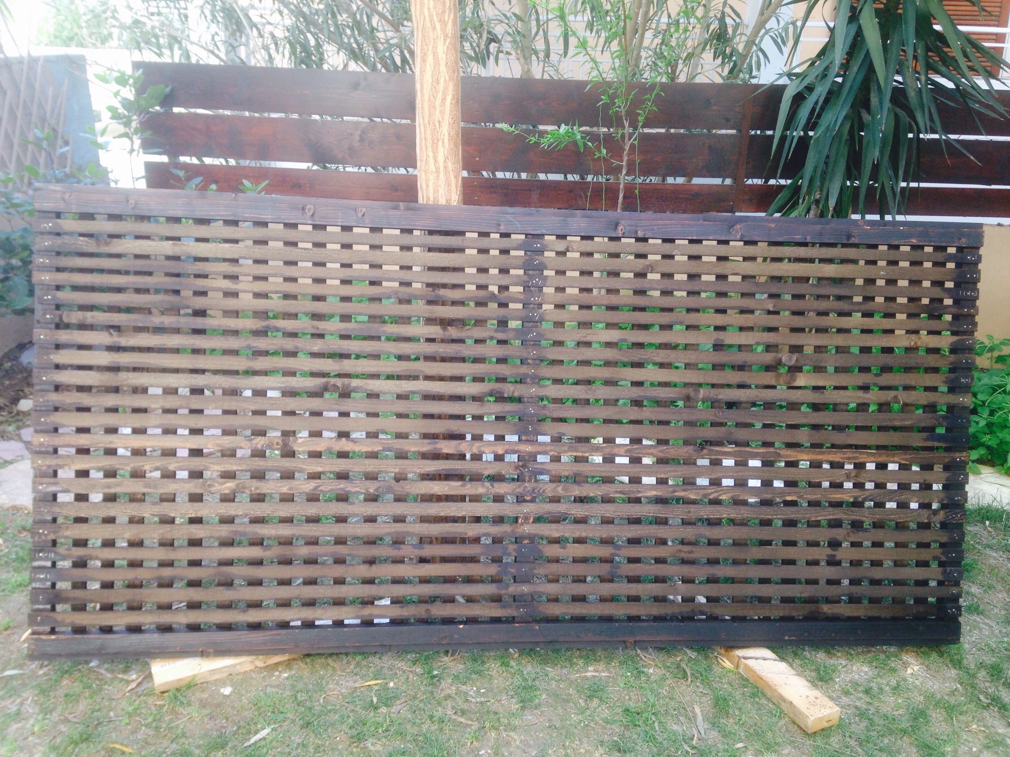

2 metallic bases , 2 galvanized corner connections , 2 pieces of 4'x5'cm , 2 pieces of 1,5'cm x 4'cm and 2 4m pieces bought very cheap from the local market.
First I have build the frame using the thickest pieces and then I have nailed on it the smallest ones to create the trellis.
Then applied 3 layers of non toxic water based wood paint for protection against sun and rain.
Step 2: Installing
At first I have installed the metallic bases on the low wall , then , the frame and at the end in order to have a better stability one galvanized metallic corner on each side of the trellis.
