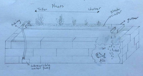

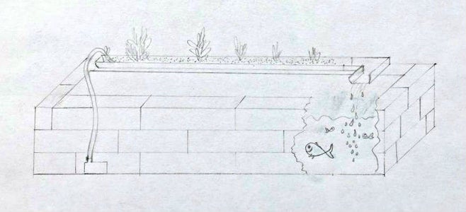

Sketch what would work best for you, whether you would use a bucket, a tank or a pond to hold the fish and plan on where you would put the gutter and how long you would need.
After you decide on what to use, all you need are:
A pond you already have or a container to hold the fish in.
A submersible water pump matching the size of your fish container. A small, economical one would work for this purpose, even if it pumps just drips of water.
Tubing that fits your pump. I used an extra hose that came with the washer.
Fish and fish food. Bulk koi food from the feed store is inexpensive and works nicely.
Plants.
Black cinder, about $ 4.00 a bag.
A gutter, about $ 5.00, end cap and an "L" connector.
Assemble as shown on the diagram.
How it works:
The fish waste containing amonia is broken down into nutrients needed by the plants and the clean water is circulated back into the pond for the happy fish.

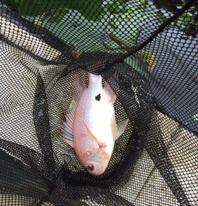

Step 3: Getting the Fish

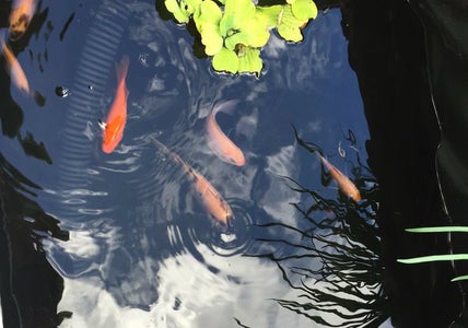

Catch or buy freshwater fish.
Tilapia is popular but others will do. Remember to feed the fish. Floating food is best to prevent the food from getting into the water pump. Feed just enough amount to be consumed within five minutes to prevent the food from rotting and contaminating the water.

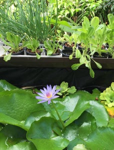

Though unusual, I keep my pond plants in the pond, too. This way, the ghettoponic plants blend in well with the pondscape and I can continue enjoying my waterlillies and other water plants.

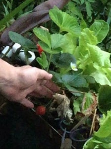

When the leaves look good enough to eat, harvest some leaves from each plants and let the main part of the of the plants keep growing and make more leaves until they can't produce anymore. Start new seedlings to make sure you will have continuous supplyof fresh veggies and fruits.
Strawberry plants multiply. Separate baby plants and plant them right in!

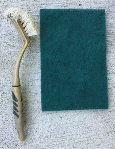

Kitchen brush and scrubber are all you need. Simple!
If you choose to, adding a scrubbing pad at the water input to filter out the water from the pump would keep the water in the gutter clean longer.
To clean the scrubbing pads, spray with water.

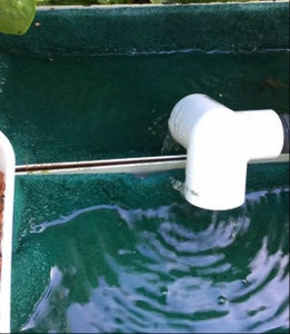

Split the water source by using more tubings and PVC "T"s, conectors, valves, clamps and teflon plumbing tape. A 3-Way elbow fitting is really good for the water input into the gutters. It prevents unwanted drips into the gaps between the side-by-side gutters since the water is directed at an angle. Threaded ones are easier to connect and more secure. I did not permanently connect the PVCs using glue since I would like to have the option to move them around from time to time as needed.
Splitting carries some advantages. Separate the water-lovers such as the lettuces from the low water-lovers such as collard greens, strawberries, kales, spinaches and baby plants. By using a valve to control the water, we could eliminate the need for a siphon, which could be pricey and complicated to make.
Scrubbing pads could be used as a ghettofilter to catch the debris from the black cinder and plant material. I got a free plant tray from a nursery to hold them. I used imitation sinew to hang the tray underneath the gutter output but any strong string would work.
An air pump is not needed when the surface area of the pond is big enough and the pond is not overcrowded. Make sure there is enough clearance between the gutter output and the pond water. This will allow for the water to diffuse air into the pond. If the fish are gasping for air, it means you probably need an air pump, which is inexpensive, too.

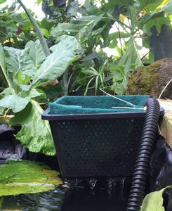

Step 8: A Totally Optional Way to Keep the Pond Cleaner
Since the ghettoponics do not require much water, most of the water could be split and directed into a bigger filter. This will increase the water clarity and provide more oxygen.
Commercially available filters could be very expensive.

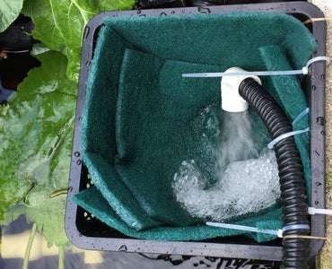

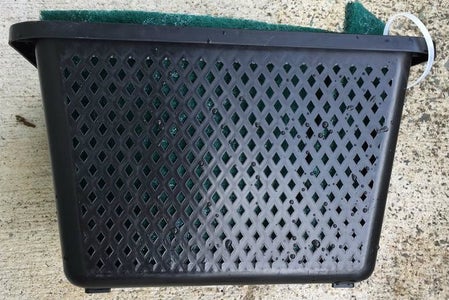

Make a bigger ghettofilter:
Line a holey basket or net pot with overlapping scrubbing pads.
Use zip ties and sinew to hold the tubing still and to hang the basket over the pond.
