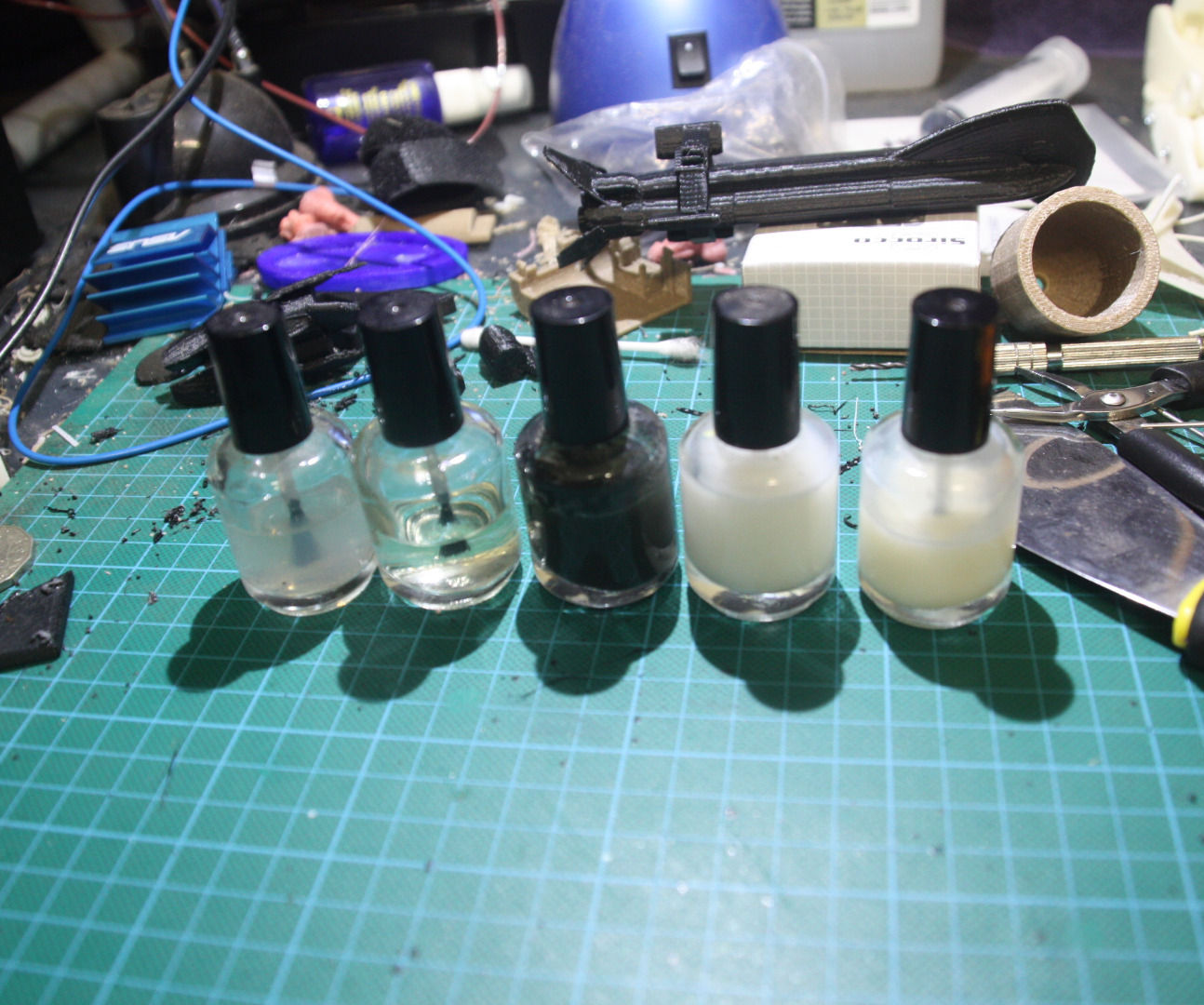

I also got a 25ml syringe with a piece of tubing that had a 4ml interior diameter from a pet store (used for air lines on fish tanks) so that I could accurately use a small amount each time. The hose and syringe is also quite useful for filling up nail polish bottles!
