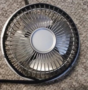

In this design, the fan pulls the air through the carbon filter. That being said, MAKE SURE that your fan is pointed outwards(away from the body of the filter). These instructions will cover a cheap and easy design but can be easily adapted to a more complex/durable one. As long as you have a GOOD SEAL on your fan and filter, the same concepts will apply.

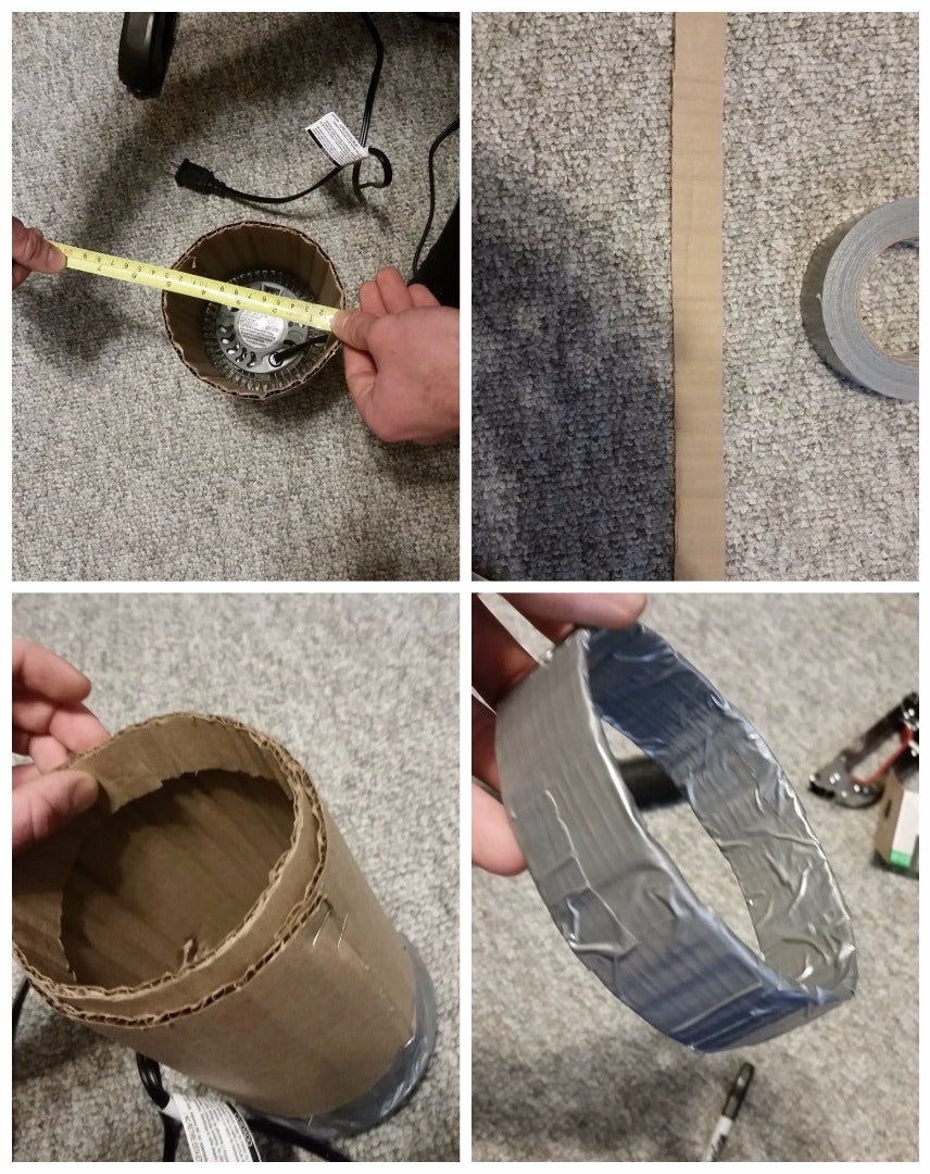

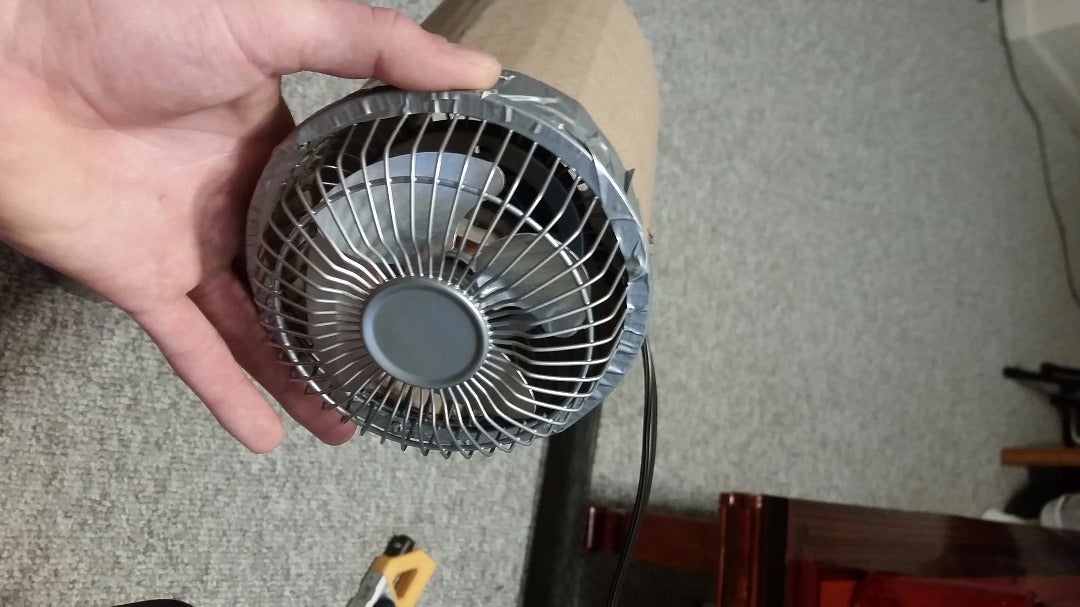

1) Measure the circumference of your fan. This can be done by taking your string (etc.) and wrapping it around the thickest part of the fan. Once you have fully wrapped the string around the fan, mark the length of the string that you used so that this length can be measured. Now, use your ruler or tape measurer to determine the length of the string (the circumference of the fan).
2) Knowing the circumference, you can begin to measure out the piece of cardboard needed to fit over your fan. We will be drawing out a rectangle on the cardboard. Said rectangle will have a length equal to the circumference of the fan(with a little extra for overlap) and a width equal to the desired length of the cardboard tube. On your piece of cardboard, draw out a line equal to the circumference of the fan PLUS .25 inches. (The extra quarter inch allows for overlap so that you can create a cylinder from this cardboard.)
3) To determine the width of tubing that you should use measure the depth of the fan and multiply this number by three.
4) Cut out this rectangular piece of cardboard and roll it along the grain (corrugation) until the material becomes malleable enough to form a cylinder.
Step 3: Closing Up the Body of the Filter

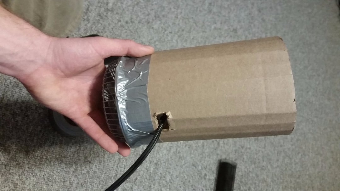

5) Wrap your rolled piece of cardboard around the fan as shown in the video and staple the top part shut(you are trying to form a cylinder). Now, remove the cardboard from the fan and staple up the other end of the tube. Stapling this end will form the cylinder that we need.
6) Before securing the cylinder to the fan, bear in mind that you will need a way to feed the power cord of the fan from the inside of the cylinder to the outside. One way to get the plug outside is by cutting a hole in the side of the tube just large enough to sneak the plug out. Once the plug is sticking out of the side of the tube, seal the hole around the wire with duct tape.
7) Attach the cylinder to the fan with duct tape.
IMPORTANT: Make sure that you have a very tight seal. A good seal ensures that all of the air being pulled by the fan is passing through the carbon.

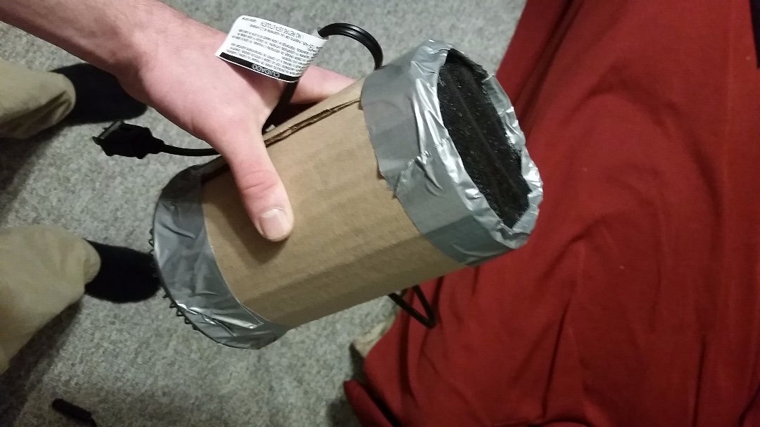

Step 4: Creating the Filter Itself
1) Measure the inner diameter of your cardboard tube attached to the fan
2) Calculate the circumference of the inside of the tube by multiplying the inner diameter by pi (3.1416)

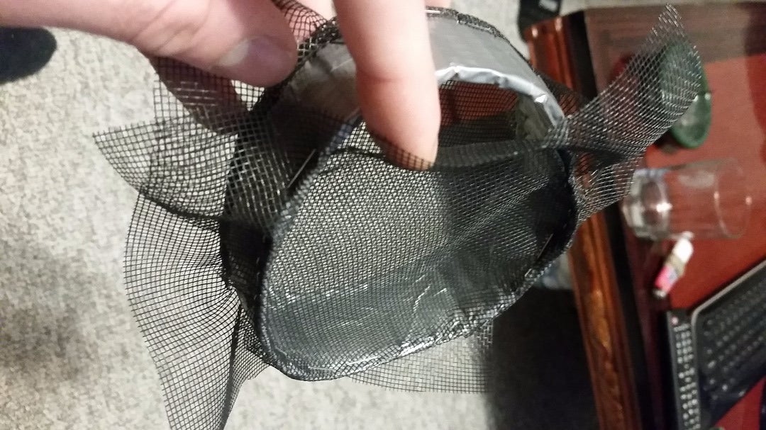

3) The circumference plus a quarter inch for overlap is going to be the length of a second piece of cardboard that we will be cutting out. The width will be 1 inch. Cut out this rectangle and wrap it in duct tape to increase its sturdiness. Form it into another cylinder (this cylinder will be only an inch tall so it’ll be like more of a disc) by stapling the top corner of each side together. Next, staple the bottom corner of each side together.
4) Make sure that your screen has a fine enough mesh for the carbon to stay in. If not, it’s ok to double or triple up the screen in order to reduce the mesh size.
5) Take your screening material and begin to staple it around the edge of one side of the disc (Almost like you’re stretching leather over a drum). You want the screen to be as taut as possible.Take your time stretching the screen over the cardboard to ensure that you have a tight fit.
Step 5: Finalizing the Filter

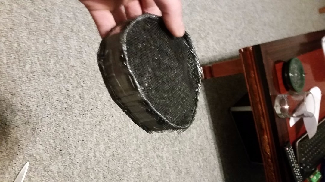

6) Once you have fully gotten this part stapled, turn the filter over and begin to secure the screening to the other side. DO NOT seal this side completely; be sure to leave enough of a gap to pour the carbon into the filter.
7) Make sure the carbon is dry. Proceed to the next step once your carbon has fully dried.
8) Make a funnel out of paper and pour the carbon into the top of the filter.
IMPORTANT:Pack your filter to the brim with carbon. Doing so will allow you to lay your filter on it's side(otherwise, the carbon will settle over time and your filter will lose efficiency).
9) Close up the last part of the screen on the remaining side and trim off any excess screening material.
Step 6: Getting Your Filter Up and Running
Now that you have built both components to the filter, they are ready to be combined and your project is almost complete. Before inserting the filter into the body attached to the fan, be sure that the switch on the back of the fan is set to the on position.(Your filter can be turned on and off by plugging it in/unplugging it or by attaching it to a surge protector and using that as a switch.) The filter can now be inserted into the cardboard tube and taped around the edges to ensure the perfect seal. Congratulations! You have now made yourself a cheap and easy air filter. The carbon should be replaced every six months to a year depending on usage and indoor air quality.
