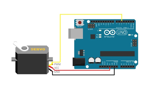

Step 1: Making the Circuit
We start by making the circuit. The servo motor acts as a lid to the food container, and the Arduino is the commonly known microcontroller. The servo motor will rotate at a certain angle therefore opening and closing the lid. You can wire it by looking at the picture above. The colors of the wires represent where they should plug into.

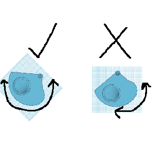

Option 2 (Not tested, should work): Get a reasonably sized cardboard box or something, and cut a hole about the same size as the servo. Your servos also should come with a small plastic bag containing the "horns" of the servos. Pick the one that is like picture 2. Now cut off a piece of cardboard a bit bigger than the size of the hole you made earlier, and glue it to the top side of the horn. Now you can attach the servo to the side of the box.

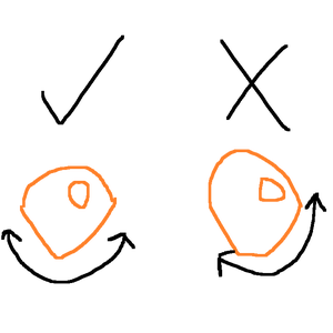

Step 3: Testing the Servo
Twist the servo horn without power connected, and it should turn ~175°. If not, change the position accordingly until you can turn it ~175°. Use the 2 (horribly drawn) pictures for reference. (lol)
