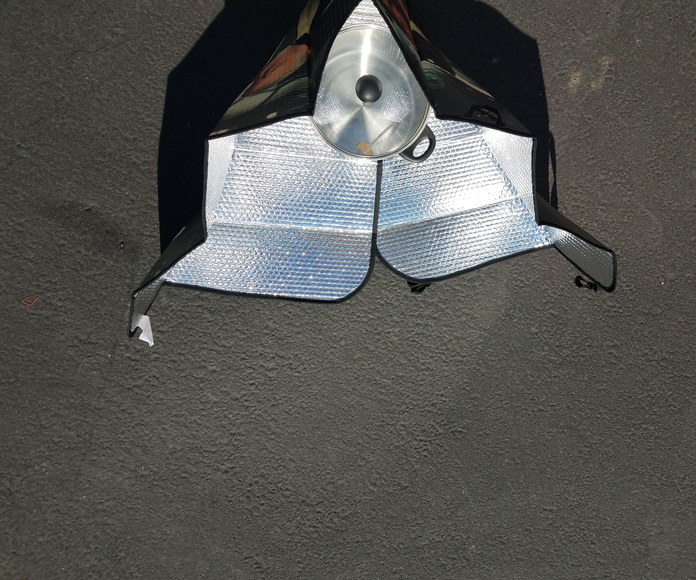

This is a Instructable on a very simple Cardboard Solar Cooker. It’s very easily made and the materials can be found almost everywhere. There is much room for improvement so if you guys can make it better in any way feel free to contact me.

Our solar cooker design uses aluminum foil to reflect and absorb the sun’s light to create heat in a focused or unfocused area which can either be used to purify stagnant water or cook easily prepared food. We have three panels attached to the cardboard reflecting the sun’s rays into the inside of it, and the inside of the box covered with the back side of aluminum foil to absorb the heat better. The plastic wrapped cardboard is to trap some of the heat inside of the box to increase the temoerature.

To make sure your solar cooker gets the maximum amount of heat, angle the flabs to where it will be able to reflect the sunlight into the the center of the box. To get the angle that we felt was best, we cut more into the box to fold it in more.
