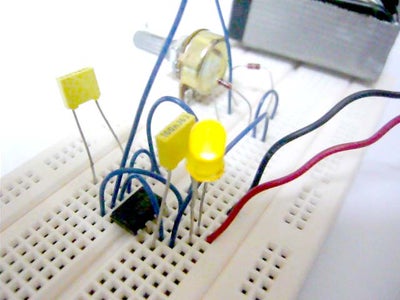

Step 2: How It Works.
How it works
When the circuit is powered up, the C1 capacitor will initially be in a discharged state. Thus, the Trigger (pin 2) will be LOW, driving the Output (pin 3) to go HIGH. Discharge (pin 7) goes HIGH and goes ground. The cycle begins.
The HIGH Output will cause C1 capacitor to be charged through the R1 and D1 path. Upon C1 voltage reaching 2/3 of +V, the Threshold (pin 6) will be activated and drive the Output (pin 3) LOW. Discharge (pin 7) goes LOW. The time it takes for C1 to charge depends on the position of R1.
Since Output (pin 3) is now LOW, capacitor C1 will start to discharge through the D2 and R1 path. When the voltage of C1 drops below 1/3 of +V, Trigger (pin 2) will be LOW, driving Output (pin 3) to go HIGH, and Discharge (pin 7) to go HIGH and shorts to ground. The cycle repeats itself.
You've probably noticed by now that the circuit is using Discharge (pin 7) to drive the motor, simply by going ground in each cycle. You can add some amount of protection if you're concerned about back EMF from the motor.
Pin 4 and 5 are not used, and pin 1 is simply tied to ground. The circuit can take between +3v to +18v. The Frequency is around 144Hz. Do note that, doubling the value of C1 will reduce frequency to half, tripling will will reduce frequency to 1/3, and so on.
