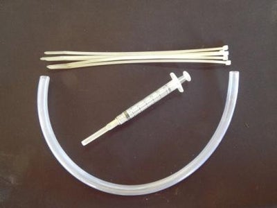

As simple as - PVC tubing 3/8 diameter, 3 ml syringes with needle, (or better yet just the needles) as much as you need, some nylon straps to keep things together, a cheap timer, an input electro valve recovered from an old washing machine and a power cord.
The tubing is a thin wall flexible PVC tubing or some other you find convenient, but that can be easily pierced by a siringe needle.

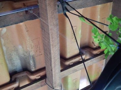

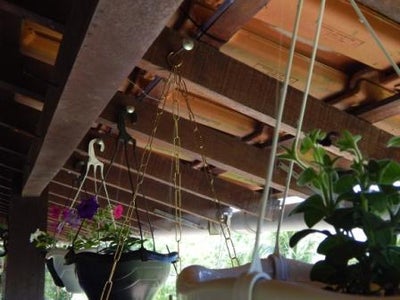

In my case, the flower pots are hanging from the porch beams and it gave me all the opportunities I needed to fit the tubing to the whole path. I spent almost 30 meters of tubing to reach all the pots. I fit the tubing each 30 centimeters or so with a nylon strap, but avoiding to squeeze the tubing to keep the free water path.

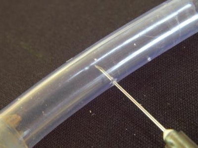

The real tricks are the insertion of the needle and its fixup.

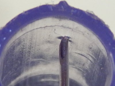

To open a watering point, just insert a needle pointing to the spot you want to water. Now keep going until you TOUCH the opposite internal side of the tubing with the needle tip BUT be careful to not pierce the other wall. This permits to adjust the needle position by altering the direction of the stream and the tip of the needle just touching the inner wall will keep it from moving away. Nothing that strong but quite effective. And you can always move it as you need. BUT remember - be careful not to go all the way trough or you wiil have no water coming out followed by a leak on both sides. We certainly do not want it.
Since all these parts can vary, you can find your own solutions based on what you have at hand.
