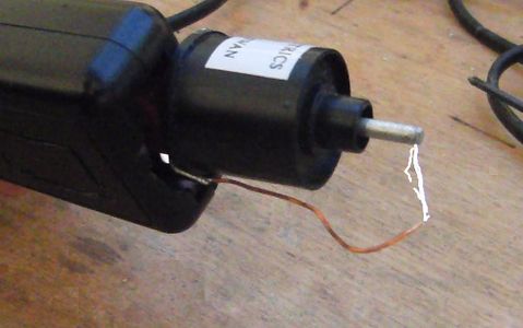

Step 2: Instructions
1. Get your cap charger
2. Cut out a hole for the switch
3. Drill or melt 2 1mm holes into the front, and attach the coil as shown in the video
4. Solder GDT to the coil
5. Solder the MKP to the other pin of the coil
6. Connect GDT to MKP+ (the MKP is not polarized, but + is where +input from the charger goes :)
7. Connect MKP+ to cap charger+OUT, and MKP- (connected to coil), to charger-OUT
8. Solder the switch to charger+IN, and the battery holder+
9. Solder charger-IN to battery holder-
10. Put in the AAA and test fire :>
