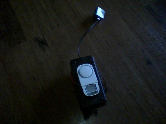

Step 2: Assembly
this is the easiest and the hardest step. I'll try to give detailed directions.
for the main relay power loss switch:
positive in connects to the common and the momentary switch
the negative connects to one side of the relay coil and 2.2k ohm resistor
the momentary switch connects to the other side of the relay coil, the normally open connection on the relay and the power indicator LED
diode 1 is reverse bias across the relay coil to cancel back emf when the magnetic field colapses
power indicator LED is connected to 2.2k resistor
if you are using non-rechargeable batteries:
battery positive connects to common
relay normally closed connects to output
battery negative connects to output
if you are using rechargeable batteries refer to the diagram below. this is a trial and error approach involving voltage drops and current limiting. you want the voltage when it reaches the batteries to be about 5v to 5.4v which is and medium charge on my 4.8v battery pack. and the current should be about 1/100th of the battery rating in my case it trickle charges are 3ma 1/266th.
it was at 1/125th before I added the 390 ohm resistor. even so the batteries get upto 5.45v from 5.1 in about 3 hours but at that rate it will never fully charge because of normal discharge of the batteries.
so you understand why the batteries won't fully charge with this system NiMH batteries lose 10% of their charge within 24 hours of full charge so that 90%-100% area has a high discharge rate which actually protects the batteries in this case.
