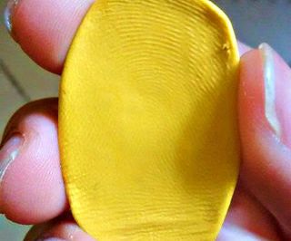

Step 9: Filling With Sugru!
You can see gaps between the sheet metal and the laptop. To fill these gaps up and smoothen the sharp edges, use Sugru or Hot Glue.
