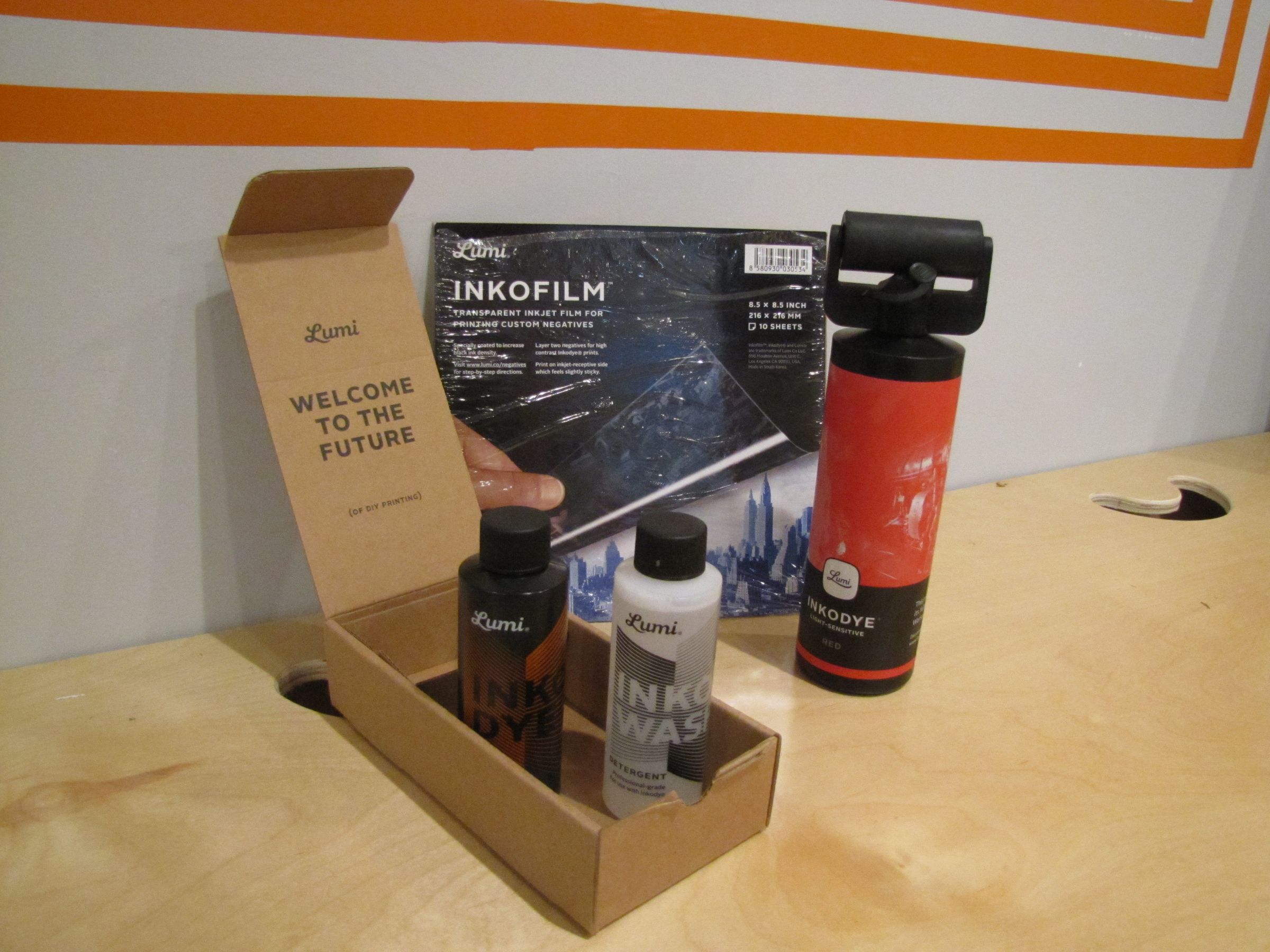

If you haven't heard of lumi photoreactive dye, check them out. http://lumi.co/ They fronted us a really cool kit, with red and orange dye, some washing solution, a roller for the dye and some of their very nice inkofilm.
The kit is ideal for setting up a small batch of shirts, or putting your personal touch on anything made of natural fiber.
