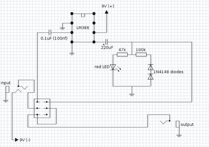

Step 2: The Schematic
Now it's time to build one for yourself too!
This is what you need:
6.3mm stereo female jack
6.3mm mono female jack
DPDT switch
0.1uF capacitor
LM386 op-amp
220uF electrolytic capacitor
47k resistor
100k resistor
red LED
two 1N4148 diodes
Incase you don't know, how to read schematics, there are a plenty of tutorials available. Just Google
