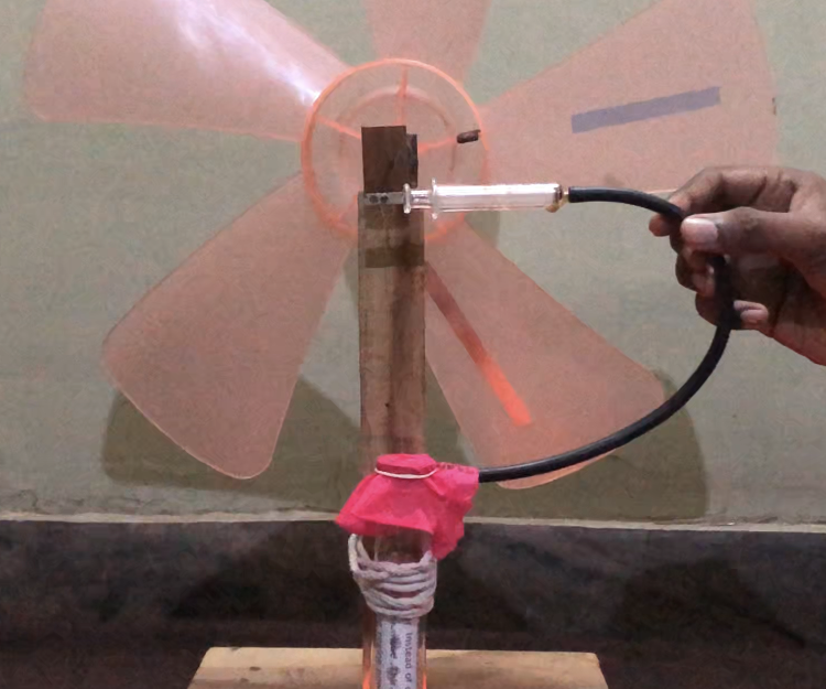

Step 1: Making the Suction Stroke
Suction stroke requires a 10ml syringe, remove the head of the syringe using an hacksaw, you can see that in picture. Be careful dont reduce the syringe length too much. The purpose for removing the head is to create more suction pressure if the hole is too small suction will be less and becomes difficult to deliver enough water. And after cutting it try to insert the syringe into the 1/2" flexible tube as shown in the picture.
Step 2: Making the Delivery Stroke
Use one of the end caps for this purpose, make a hole of 5mm diameter using the hand drill. Since i dont have hand driller i made the hole by melting the top surface of the cap. it should look as shown in the picture.
Step 3: Making the Pipes
You can make the pipes for suction and delivery stroke for required size but i recommend to use 150mm length for the top and bottom pipes, 45mm length for the pipe at the centre and 20mm length for the pipe placed at the delivery stroke. Using the other end cap close the top end of the delivery stroke to prevent the loss of pressure in the pump. Leakage may decrease the efficiency.
Step 4: Placing the Valves
place the two marbles as shown in the picture because this is the heart of the pump which acts as valves. Place one marble at the suction stroke and other marble at delivery stroke.
Step 5: Assembly
Put all the things together and should look as shown in the picture. Take a look at the video how the pump performs.
