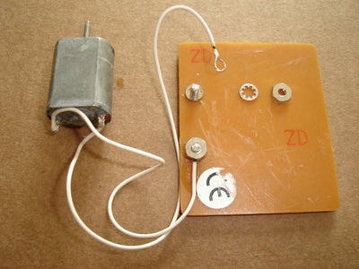

Step 2: Step 3 Electric Connections

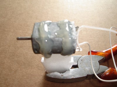

You start out with soldering two electric wires to the motor.

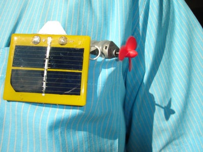

Next you make the connection with solar module. Put the propeller on the motor's shaft provisionally to check it is spinning in the right direction with the solar panel in direct sunlight. If not, reverse wires.
Most laminated/molded solar modules have contacts wit threaded studs and nuts instead of soldering lips. Do not try to solder on them as their coating will make that very difficult. Make an eyelet to the wire and attach it with a washer and a nut (most often included when purchasing the solar module).

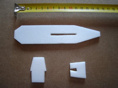

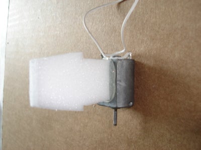

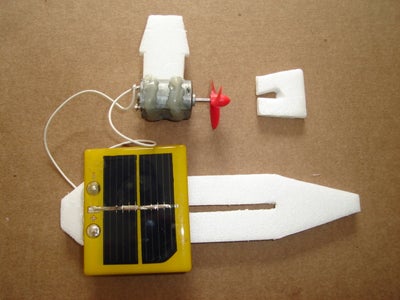

Cut out the body of the sub from the sheet material. Cut it out to large, you will trim it later by cutting it smaller. Cut a sail/keel piece and a rudder and glue the parts as shown in the pictures.
You are ready to go and find some sun and water for a dive. However do check the following steps on assembling, trimming and depth control before you leave. Thake your sccissors with you.

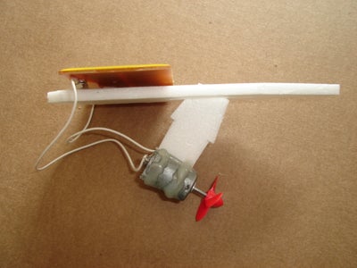

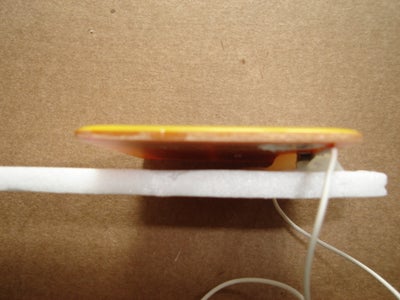

Step 5: On the Spot Assembling and Trimming

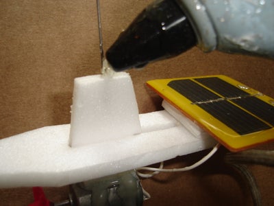

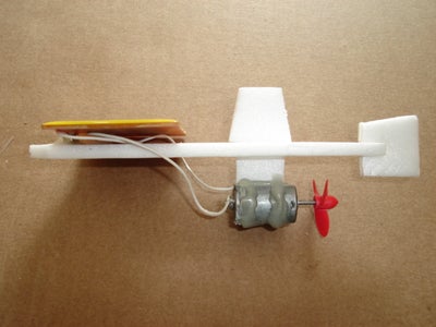

Before you start trimming you should decide if you are going to use the "periscope style" depth control explained in the last step. If so, add it now, in order to take in account the correct total weight when trimming.

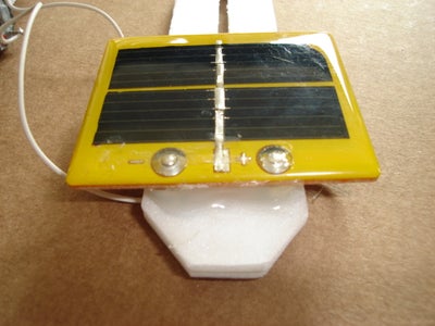

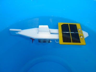

Assemble the parts as shown in the picture. Put the sub in the water. Make sure the motor is filled wit water before starting to trim. Either tap on it with any holes in the motor positioned at the top, or if possible place it under a running tap with one of the openings. A little air left in the motor is not that bad, but to much will make you "overtrim" and your sub risks not surfacing anymore once the air finally does escape from the motor when running.

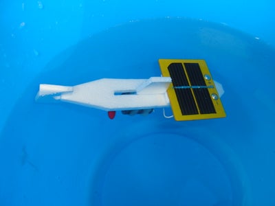

The last picture shows how to trim (I did it in a bucket for convenience). Once the solar panel catches some sun your sub will run, for the moment remaining at the surface. To dive check out the next step. If you accidently "overtrim", having the sub dive/sink even without running forward, you can always add some floating material back again. Glue it with hot melt or a little super glue, or slide it firmly under the "clip" formed by the solar module.

Now slide the sail/keel/motor assembly forward, making it lean forward. The surface of the solar module will act as depth rudder and push the sub downwards (dynamic diving).
If under direct sunlight and with the motor completely at the bow side of the slit, the sub still does not dive, carefully remove a little floating material at the bow. Do not remove to much, as your sub should still float to the surface when the motor stops by making shadow over it. This is your first way to control the depth.

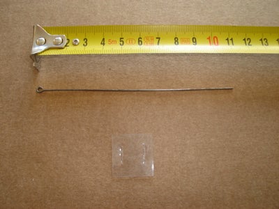

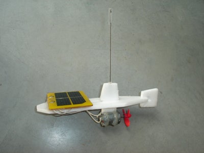

Take a piece of thin steel or brass wire, 10 cm or longer. Stick it in the sail as if it where a periscope or antenna. Slide over a slitted piece plastic as shown. Using clear plastic gives a nice result, being almost invisible in the water. You can cut it from blister packaging or from a overhead projector slide.
Now, when diving, the plastic sheet will hit the water surface and as a kind of break level out the sub, making it not going any deeper. You can have it run at periscope depth, or if you put the plastic piece at the top end and carefully trim it by cutting it smaller, you can make the sub run just under the surface. Just under the surface it will cause a ripple and experience just a little less resistance than when going deeper under the surface. Sliding the motor a little back again can and bending the steel wire can also help trim to get the right effect. Just enjoy trying it out.
April 13th 2008: I have added a video showing the good performance of this type of depth control. In this is example it is a slightly different little sub, with a body made of a laminated paper colour drawing and battery powered (as it is used in an indoor pool).
