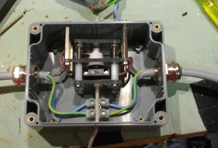

Step 6: Put It in a Box.
So that's the idea behind my soldering iron timer, pretty tricky hey? I'll show you how I made mine, enclosures, hardware etc., but feel free to package it up however you want.
