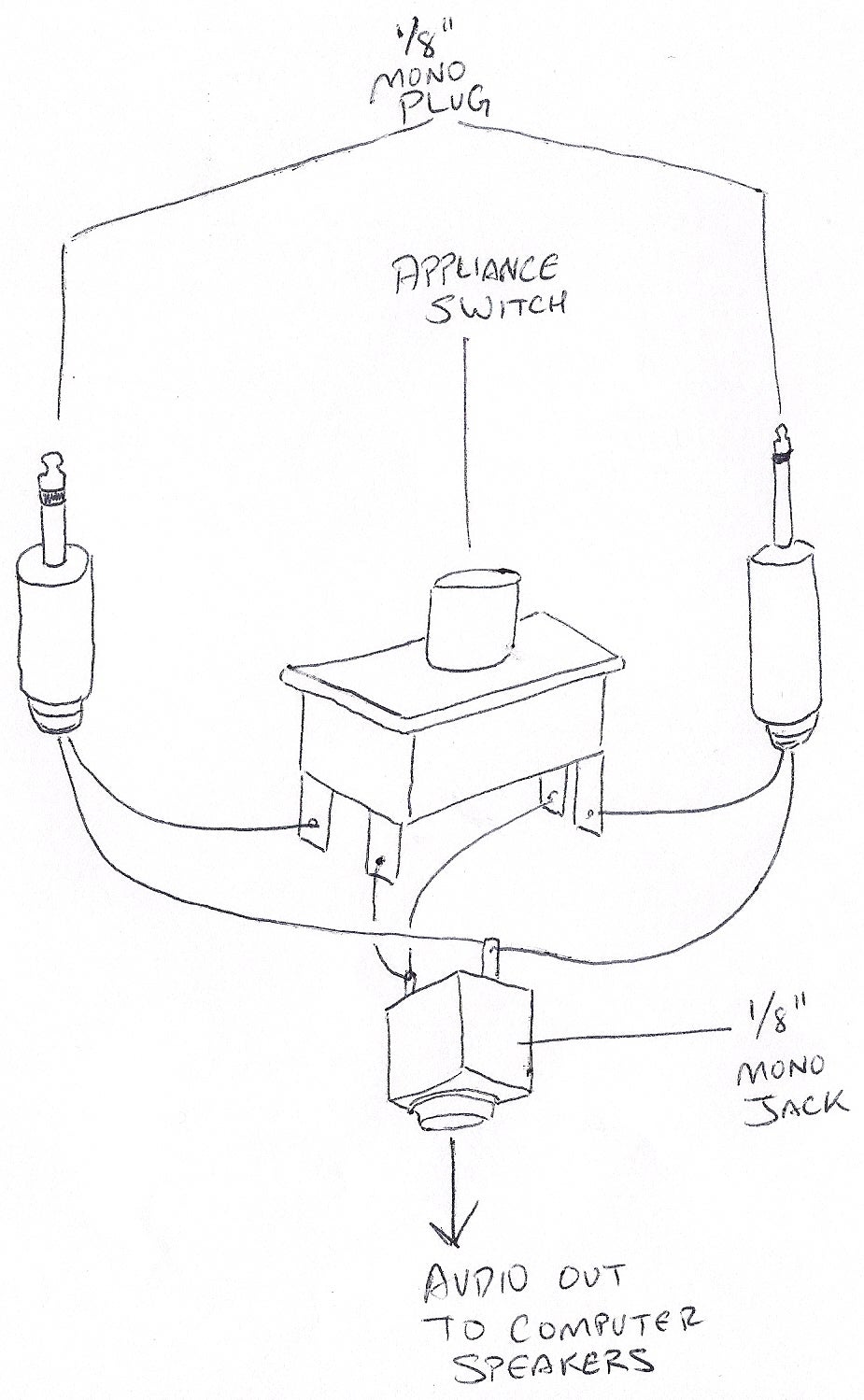

Step 3: The Appliance Switch & Mp3 Players
The heart of the audio portion of the project is this switch. To explain this I'll put it in terms that anyone can relate to, your clothes dryer. When you open you clothes dryer door, the dryer goes off & the light comes on & when you close the door the light goes out & the dryer will operate again. It is this configuration that makes the audio switch from one sound to the other in a very simple way. There are 4 contacts on the back of the switch, 2 for what would be the light & 2 for what would be the dryer.
There are two sounds for this project, a dormant or background sound, and an attention getting sound. For the background sound we will wire two wires up to the two contacts that allow electricity to flow when the switch is held closed. The other two contacts will be used for the attention getting sound.
One very important detail is you need mp3 players that will play a song repeatedly. I think most mp3 players are capable of this. I used IPods, because It's what I had available & only needed it for a short time. Really all that I did was break connection from the output of the mp3 player with the switch. When the switch is closed the connection for the sound output from one mp3 player is closed & you hear that sound while the connection for the other mp3 is broken. When the switch is opened, the opposite happens & you hear the audio from the other mp3 player.
What is happening if you look at the diagram is that we either have one or the other plug making a complete circuit. So that when the switch is open you hear the sound from one mp3 player & when the switch is closed you hear the sound from the other mp3 player.
