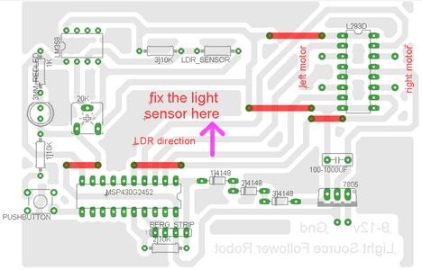

If you have some experience making printed circuit boards then you can use the attached eagle file.
along with the design files, i have uploaded the different views of the PCB, to help you to place components correctly. when you open your file, dont forget to click on the 'ratsnest' button in order to fill the gaps between the lines. (see images)
Do cross check the PCB design with the circuit diagram of your own before implementing it, because i have not etched the board myself.

The LDR sensor which we made in the earlier steps will be fixed at the centre of the circuit board facing forward.
