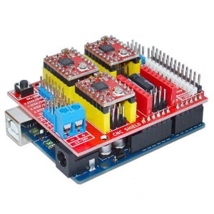

  • CNC shield (not necessary, it is possible to wire it without it, but the shield makes it a lot easier)
  • A4988 Stepper Motor Drivers

The wire that comes with the pixy 2 should be fitted onto the camera and then attached to the ICSP pins on the Arduino in such a way that the rest of the cable goes farther away from the board. This also prevents any shields from being attached to the Arduino, I attached all of the pins from the CNC shield to the Arduino with male to female jumper wires.
Step 3: Configuring the CNC Shield
The wires from the stepper motor should be run to the x and y motor slots on the shield. A jumper should be placed connecting the middle pin out of the 3 sets of 2 pins under the capacitor so that the motor is in double stepping mode. A jumper should be placed on the left of the shield connecting the two pins "EN/GND." I used A4988 stepper motor drivers which attach on to the shield in a way that the pin that says "EN" on the driver is in the top left of the shield. The current for the stepper motors should be properly limited by using the screws on the bottom of the A4988 board. HowToMechatronics has a good guide on how to do this at https://howtomechatronics.com/tutorials/arduino/stepper-motors-and-arduino-the-ultimate-guide/ Finally, once everything is properly connected, a 12 volt power source should be inputted into the blue terminal block near the bottom left of the shield.
