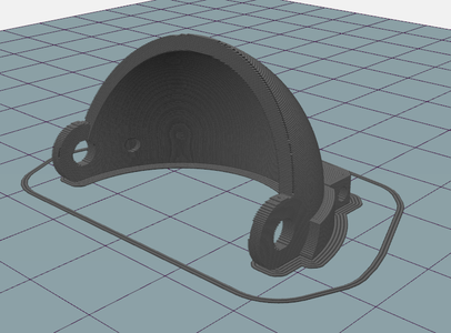

Printing may be somewhat challenging due to the small parts, but the majority of the parts print quickly and easily without supports. I used PLA for all my parts other than the eyes (which were ABS as it looks a bit more natural). There are a few delicate parts to look out for as well, but if you're using decent quality filament and you're happy with your print settings you should be fine. Finally, I used a layer height of 0.2mm and this was more than precise enough for this model - I suspect you could get away with 0.3mm even.

The parts are designed to print such that some holes are undersized enough to be directly screwed into, whereas others are oversized enough so the screw will pass through them snugly. If your printer is making the holes to small to screw into or rotate smoothly around however you can use a little hand drill to drill out some of the holes to make them more precise, and tapping threads is an option too (although PLA usually grips screws fairly well anyway). Check the images for a guide as to which holes should be which size.
