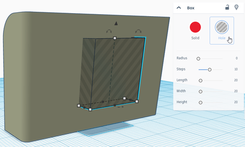

If your magnet is not the same size:
  • Find a magnet that's preferably 5 mm (0.2 in) thick.
  • Download the STL file labelled as "NoMagnet_LEDControllerHolder.stl".
  • Measure your magnet. You need the exact measurements of the magnet you are using. A pair of calipers can be handy here.

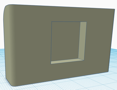

  • Import the file into your preferred CAD software. In this example I am using TinkerCAD (even though I designed the holder with Fusion360) to make this as easy and accessible as possible.
  • Create a hole the same size as your magnet. Make sure to get the tolerance right. Add a little (0.2 mm) extra to all sides of the magnet (but preserve the 5mm thickness) to make sure you can fit it in.For this example, I created a square magnet that's 20 x 20 mm and 5 mm thick. In TinkerCAD, I created a box, selected "Hole", positioned it to be 5 mm deep inside the main body from the back in the center and grouped the two objects.
  • Export your new design as STL and download it.

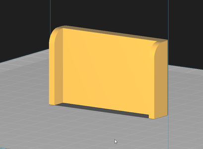

Step 2: Printing the Model
As mentioned above, this project utilizes a 3D printer to print the main frame for the holder. I printed it with my Kingroon KP3S Pro, but you can use any 3D printer with a build volume larger than 59 x 13 x 35 mm or 2.32 x 0.51 x 1.38 in (width x depth x height). That means you should be able to print this model with practically any 3D printer.
Recommended print settings
For this project, I used black PETG. However, as this model does not require much strength, you can use any hard plastic. However, be careful with the thin plastic part hiding the magnet in the center. It can be quite brittle, especially with PLA!
I used a 0.4mm nozzle, 0.2mm layer height and printed with 30% infill (you can get away with less). No supports required. You can use brim if you have trouble with bed adhesion.
You should position the model standing upright (like in the image).
