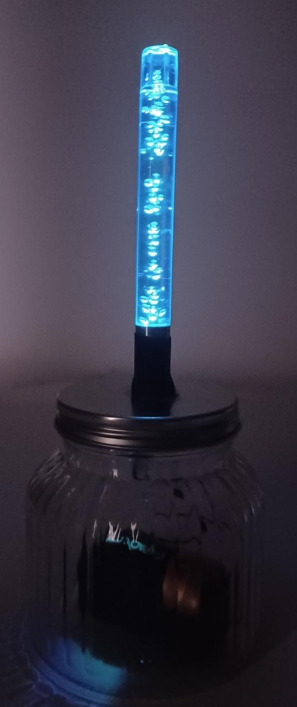

Step 6: Illuminated Terrarium
The LED was upgraded to a Piranha LED. I glued the battery holder to the inside of the lid. The jar can be used to display anything that will fit.
