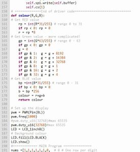

This page shows the last few lines of the driver code, a routine to set the colour in 2 bytes, needed by the display, from the more usual colour definition in 3 bytes(R,G,B) with values in the range 0 - 255. (All this has been explained in one of my previous Instructables.)
The final section sets up the display, its brightness and clears the screen to a black background.

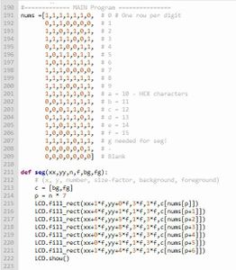

This page is the meat of the project. The codes for the characters are saved and the routine to draw a single character in various sizes is shown.
seg(xx, yy, n, f, bg, fg)
This draws one symbol with the origin(top-left) at (xx, yy), symbol number n with size factor f with a background colour of bg and a foreground colour of fg.
Because the pixel(x, y, colour) instruction includes the colour information we only have to go through the code once. We just change the colour of a segment to update the character shown. This is very efficient.
