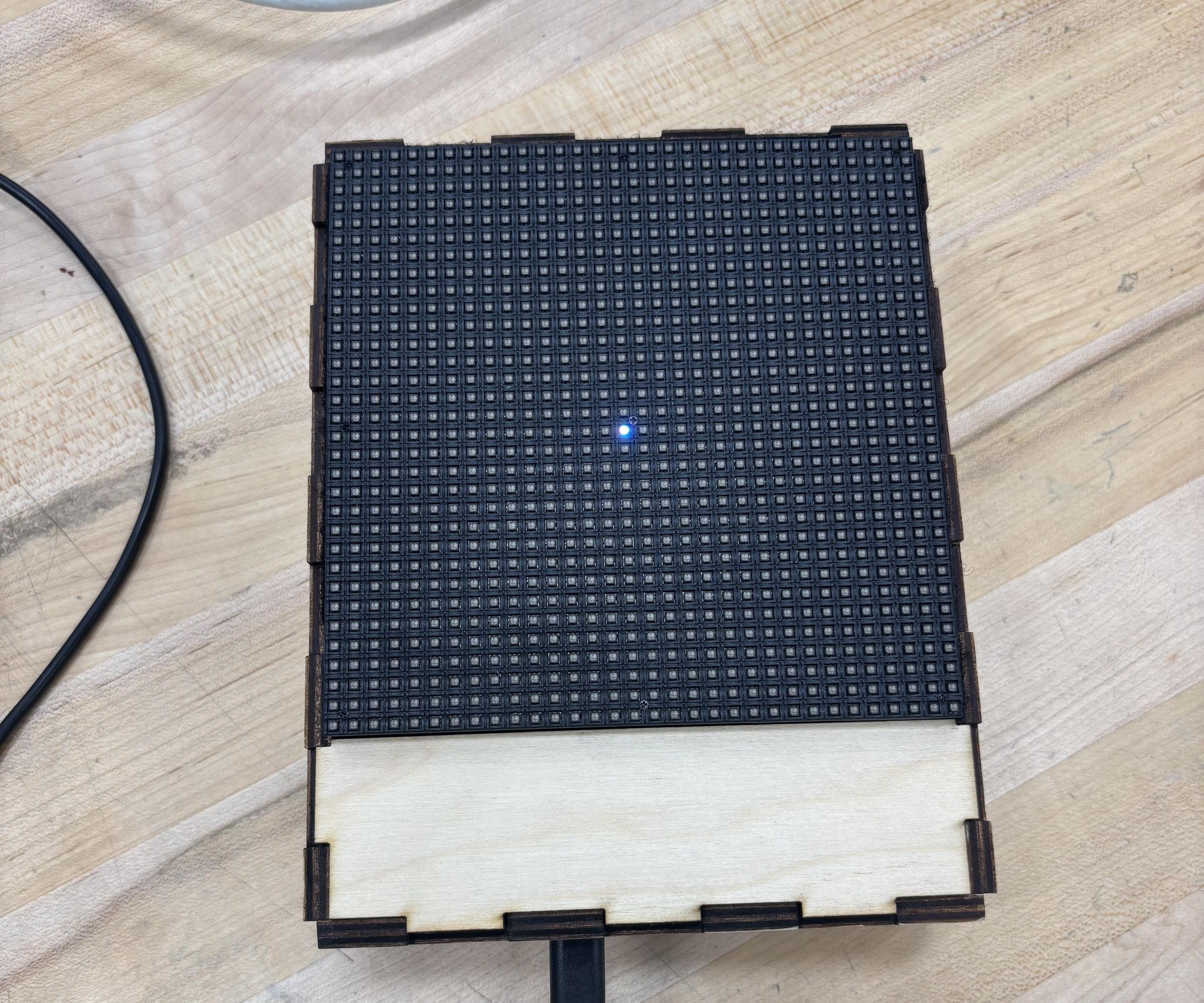

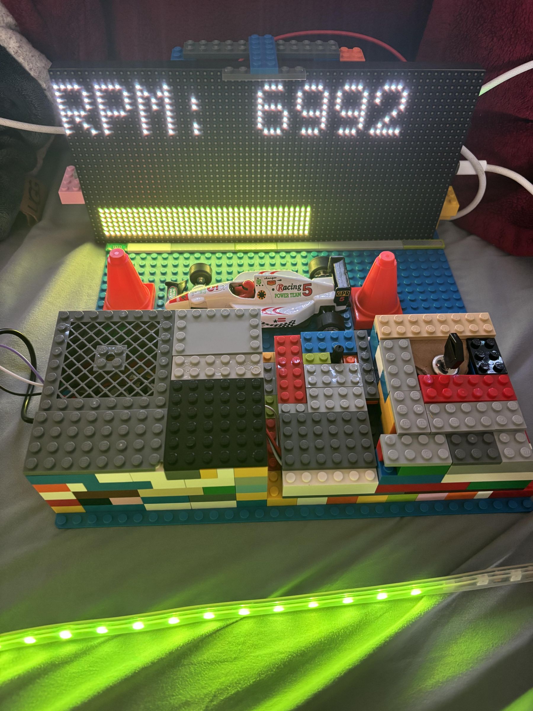

Step 5: Laser Cutting / Assembling Your Containers
Because this was somewhat of a childhood dream of mine, I thought it would be fun to build this out of Legos, as they were what my toy cars would be made out of. These laser cut files will house both the pico and matrix portal, however, as they were not part of my project. If you are to build them, assemble with super glue and then mount the electronics inside.
If you are building with legos, assemble your containers with room for wiring in mind and then some minimal movement.
Place all electronics inside, and plug them in!
Step 6: Enjoy
Thank you for following my Instructable, I hope you enjoy!
