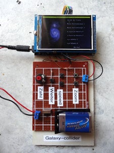

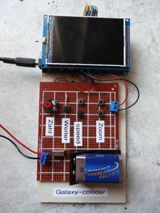

For this science project you need just an Arduino Due and a 320x480 pixel display you can plug on the Arduino Due. For the input you need 5 resistors, 5 push buttons and 1 potentiometer, that's all.
With the 5 push buttons you change the zoom, the time-step and one button is for continue in the menu. With the potentiometer you can input the number of stars and their mass.

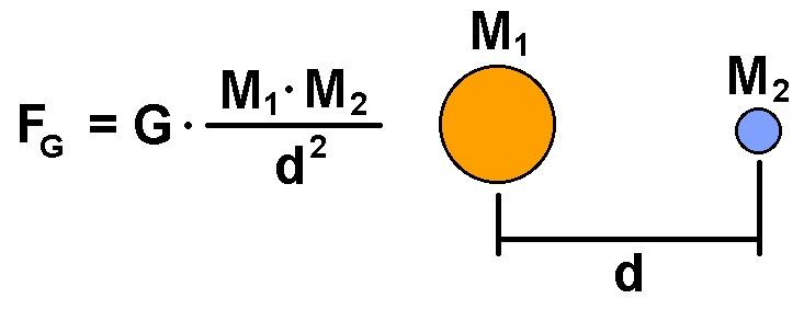

The individual stars and black holes interact via their gravitational force. Newton's law of gravity describes the force F between the two masses m and M at a distance r. According to Newton's equation of motion F = m*a, this force F leads to an acceleration a of the masses. However, the acceleration a is equal to the change in speed per second.
The change in speed delta_v is therefore: delta_v = v_after - v_before = a * delta_t with the time step delta_t. If we know the current acceleration a and the previous speed v_before, we can easily determine the speed after the time step v_after. The relationship v = delta_s / delta_t = (s_after - s_before) / delta_t applies to the speed v.
If we know the position before the time step s_before and the current speed v, the position after the time step s_after can be calculated. To increase the accuracy of the calculation, the velocity v is taken as the average of the velocity before and after the time step, i.e., v = 1/2 * (v_before + v_after).
Thus, using this Euler method, we have calculated the positions after the time step. Using these new positions, we again determine the force F using the law of gravity, and then subsequently determine a_after, v_after, and s_after.

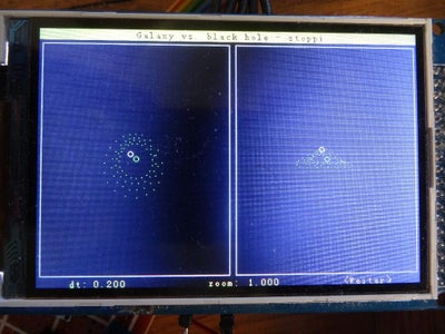

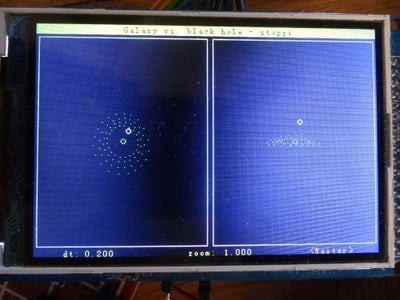

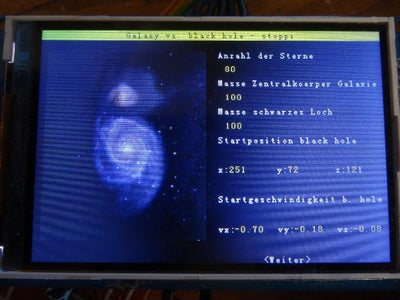

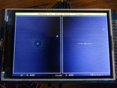

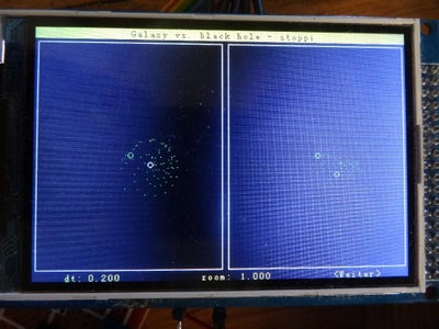

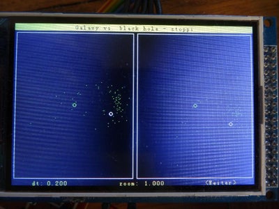

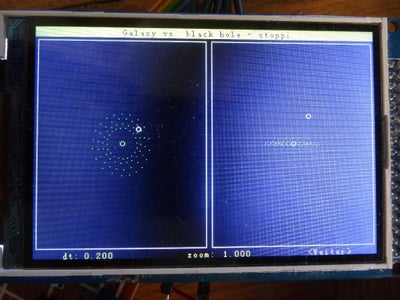

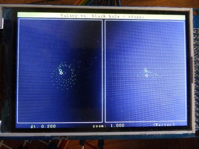

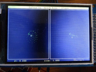

With the first Arduino-sketch you can simulate the gravitational interaction between an intruder-black hole and a galaxy.
Step 3: Galaxy Vs. Galaxy

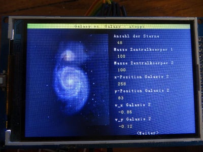

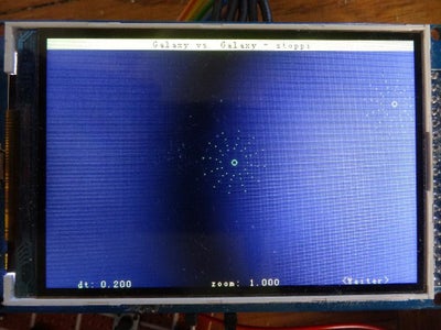

With the second sketch you are able to simulate the interaction between two galaxies like M51...
