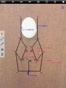

Now, we have a potential design that we would like to see if it meets our criteria. Here is the design sketched using Autodesk ForceEffect Motion.
To see whether it will pass our one-inch clearance requirement, we can trace the tips of the gripper to see its arc of motion.
Looking at the graph information, we can see that the peak displacement for each side of the gripper is 1.018”, so this design does indeed pass our clearance requirement.

To find what force we can apply to the piston to achieve these forces at the gripper, we now open the same file in Autodesk ForceEffect, another app for your iOS or Android device
From this, we see that for a 10 lb force applied at the piston, approximately 2.8 lb are applied at the gripper to each side of the egg. Since the forces scale proportionately, for a 1N force at each side of the gripper, we will need to apply 3.57 N at the piston. So, we know that we should use a piston that must supply a force between 12.7 and 77 N in order for our design to succeed.
