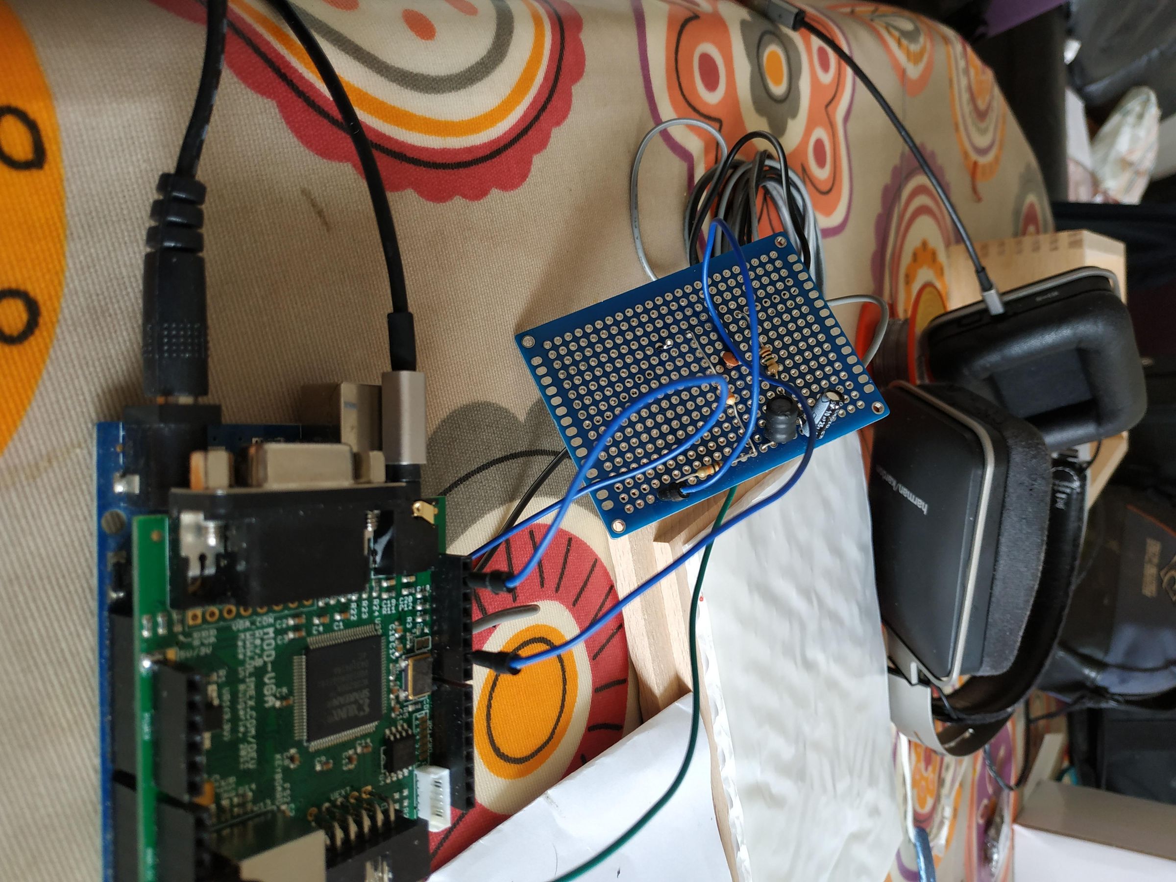

We are going to use the same shield that we used for this instructable. For the touche shield and the gameduino to work together we need to do a little hack. Since the touche shield is using pin 9 for frequency generation and the gameduino uses pin 9 for the chip select. For now all you need to know is that you should not connect the wire to the pwm pin nine but let it hang loosely (at least you should be able to disconnect it again when you are done testing).
Step 3: Making the Touché Shield and the GameDuino Play Nice Together.
Here are the steps:
- Bend pin nine on the gameduino out. Be aware that it will break if you bend it back and forth.
- Connect a wire from the bend out pin on the gameduino board to pin four on the Arduino board.
- Connect another wire from pin nine on the arduino to the pwm pin on the touch shield.

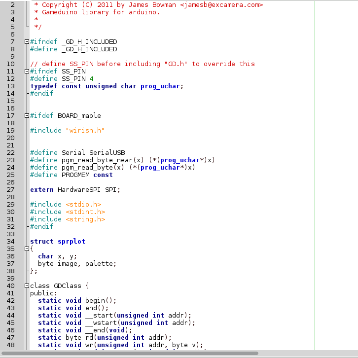

For it to work we need to make sure the Gameduino library communicates properly on pin 4 instead of pin nine. I have included a customized library for that.
