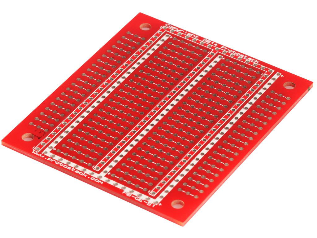

As solderless breadboards have long been the recommended way to initially evaluate circuitry their use was considered here- soldering of course should be the LAST thing to do.
The small 170 tie point (10 x17) colourful breadbreadbords shown above may tempt, but their sourcing can be an issue and ( even when turned sideways) they're  too wide (by ~4mm) for the slot.  Furthermore they annoyingly lack valuable side supply/ground rails.
Step 14: Breadboard Basics
The more widely available larger breadboard shown is usually preferable,as it's top and bottom rails allow convenient supply and ground taps. Double rail types can also be used (& they'll fit when sliced into the holder OK), but it's recommended that a top/bottom rail supply system is still followed. Marking with a red (+ve) and black (GND) spirit based felt tip pen helps clarify these rails.

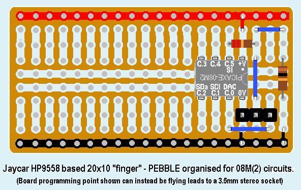

Step 15: Kiwi Board
Although veroboard/stripboard or a dedicated PCB could be used, so called "Kiwi Patch Board" suits the final soldered version. It matches solderless breadboards & it's silk screening makes it easy to "paint by number" when lifting components & links over from the tamed breadboard. Naturally it's lower profile will allow taller components to be housed too, and the extra rails in the centre "channel"  give convenience.
The approach recommended is still  to layout & evaluate on breadboard & -once the circuitry is tamed- finally solder up on suitable piece of such Kiwi Board.

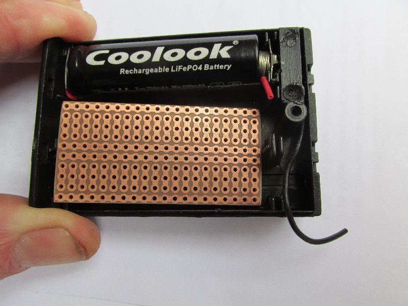

Step 22: Ready to Populate.
For breadboard work the supply and ground wires can be shortened somewhat & soldered to plug in header pins. For KiwiBoard however solder directly to the supply tracks, or perhaps a couple of header pin sockets. Don't shorted the black & red leads too much - you still want to be able to ease out the board of course.
Note the alerting LFP label in the single AA cell slot. Users may otherwise assume a standard 1.2-1.5 V AA cell type is needed and wonder why  the circuit fails to work!

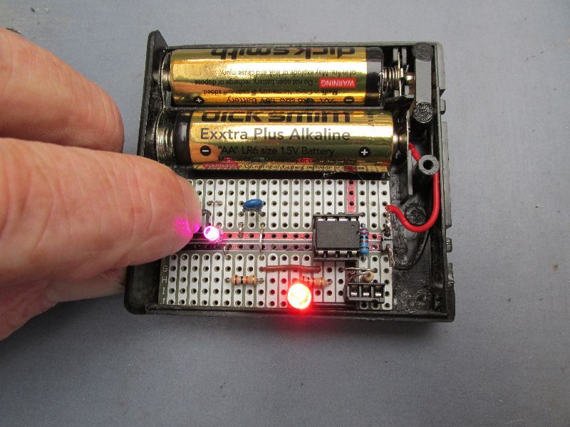

Step 23: Breadboard Circuitry
Argh-avoid such a messy breadboard layout!   Try to run wires and components low profile and neatly. Use simple colours for wiring function - red supply, black ground, blue signal etc.    Avoid burying any ICs as they'll be then both difficult to identify and remove !

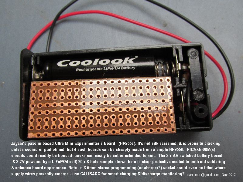

    Update: Further variations with 2 and 4 switched battery boxes have now been developed. An appealing feature of the 4 AA box is that 2 regular AA alkalines can be used (2 x 1.5 -3V) if LiFePO4 are unavailable. Some of the board slices used are fibreglass based KPB (Kiwi Patch Board), but this gets costly for small versions - it's wasteful to slice & dice a nifty KPB for trivial needs!
    For skinflints & schools I've hence also considered Australian/NZ firm Jaycar's (www.jaycar.com.au) HP9556 & HP9558 (Paxolin) boards, which can yield up to 5-10 board "fingers" from a single ~$3-$5 purchase. When deeply scored on both sides they'll crack apart nicely, & rough edges can be quickly sanded smooth. A quick spray of clear protective coating prevents track tarnishing & aids soldering nicely.
    Sure - the resulting boxed board is not that profesional,but it's logical/neat/cheap/quick & it's compact layout alerts assemblers to today's tight circuitry.
